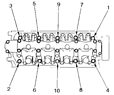

Cylinder head loosening sequence, 92-95 civic sohc engine.
Loosen bolts 1/3 of a turn in the proper sequence order to prevent warping the head.

Also we didn't loosen them in that exact sequence, we did 1, 2, 4, 3 and we loosened them a little more than 1/3 or 1/4 turn...a little over a full rotation. But it's all good, I've been wanting to bring the head to a machine shop anyway to check for warpage, I'm gonna ask them how much for a port n polish while they're at it maybe free up an extra 5 ponies with a blox IM and larger TB ;).
