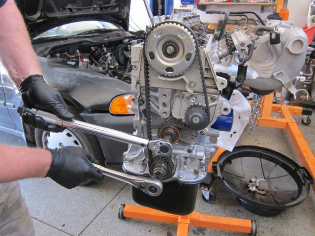

    you need to release and reset the tensioner
    you MIGHT be able to force the belt back on there but ive never tried it

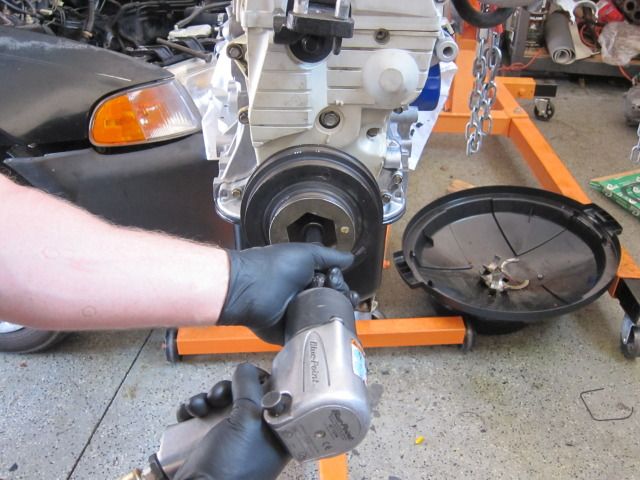

    looks like you can get to the tensioner bolt with the cover on
    credit for pics - http://honda-tech.com/showthread.php?p=47264010#post47264010
