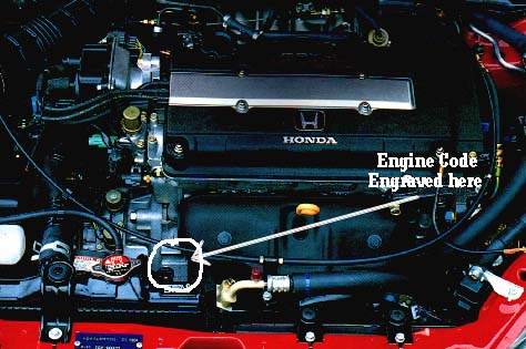

easy... look at the engine code and it will tell you what it is.
D15B2---DX
D15B6---HF
D16A6---Si
the code is by the heather close to where the engine meets the transmission.
