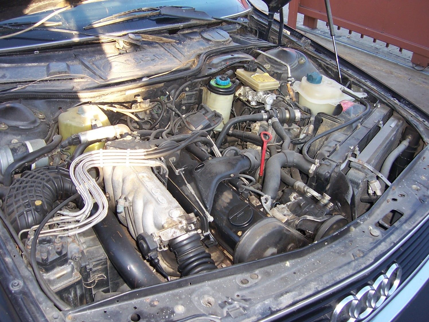

    I went to the wrecker today and fount two turbos, first was from a late 80’s Audi 5000 inline 5 and the other was from an ‘89 Chrysler Daytona (Mitsubishi). They are both 100% stock not touched, engines look clean and they have almost exactly the same mileage
    Which one should I pull?

    The Audi had this motor
    The Chrysler had this motor

    Garrett Turbo new. :thumbsup:
    I personally wouldn't choose a used turbo out of a wreck yard. But you could pull them and feel for play. Then make a judgement call. I'm guessing they're pretty small turbos but if it's forced induction on a budget :dunno: Go for it.
