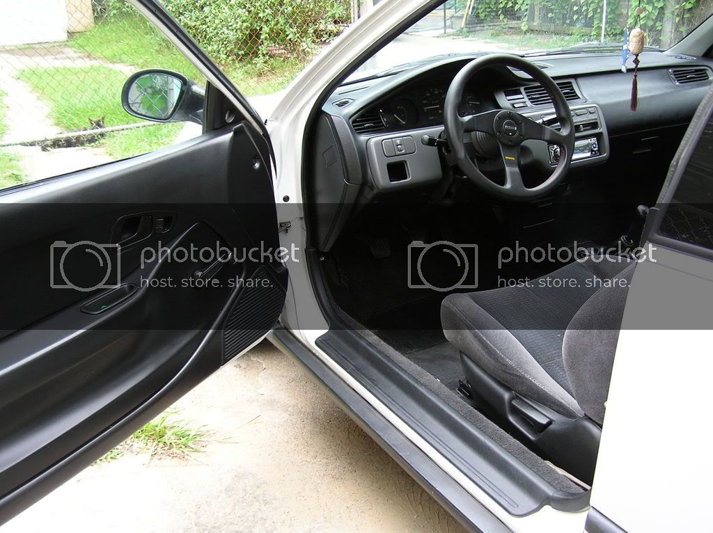

    I have painted some of my interior in the past and the "for plastic/vinyl paint" sucked. I repainted it with a semi gloss rustoleum and it looks pretty good. I have had it on the parts for two years at least and it hasn't peeled or chipped. The door panel is what I painted.
  7. Jeef
    Jeef NO MA'AM Moderator VIP
    7,266
    335
    Sep 29, 2002
    That is one of the nicest painted interiors I have seen.
    Its all in the prep work when you paint. Paint won't stick to grease, dirt, dust, armorall, etc. I would uses denatured alcohol or paint thinner (mineral spirits) to clean it with. I know people have had good luck cleaning with scrub pads and simplegreen.

    Its only the door panels. The rest is original.
