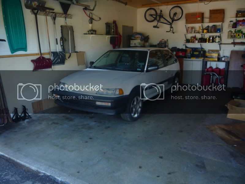

hi everyone my name is kendall. im not new to hondaswap but i have never made a post or anything. once i made an account i forgot about it. but here i am so hi all. well let me tell you a little about the honda's i drive. my daily driver is a gold 1990 civic hatchback with the stock d15b2 dpfi motor nothing special just basic bolt ons. my second car i have is a project in the process of restoration i will make a build thread about it sometime but it is a white 1990 civic hatchback jdm dohc zc that i wanna build to turbo. here are some pics of both.
her name is goldie
and her name is whitey
