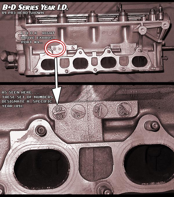

    the date is stamped above the exhaust ports on the left. It is hte first two numbers in a circle.

    peep this diagram to find the year of your head:
    What color are the distributor plugs? and how many plugs do you see on the distributor?

    Yea, that's the pic I was gonna post, but always takes me forever to find it. Why Katman, are the pics to identify cams still hosted somewhere? I checked on the FF site, but it says image not found.
