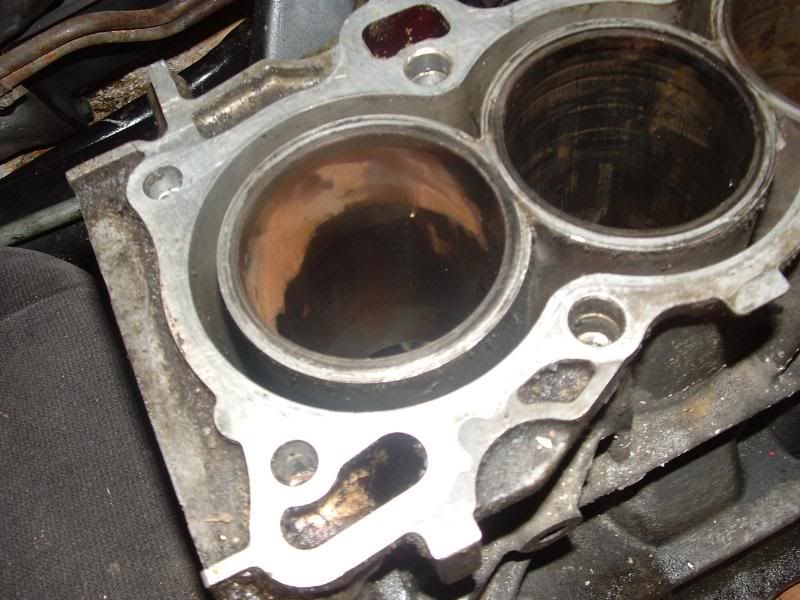

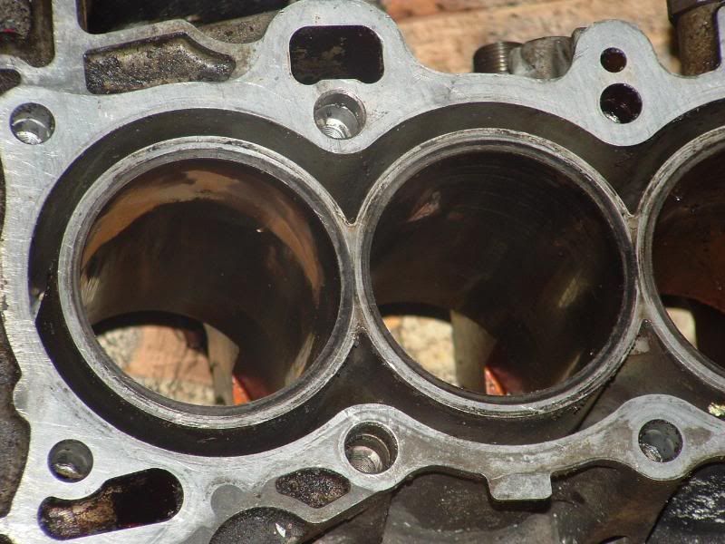

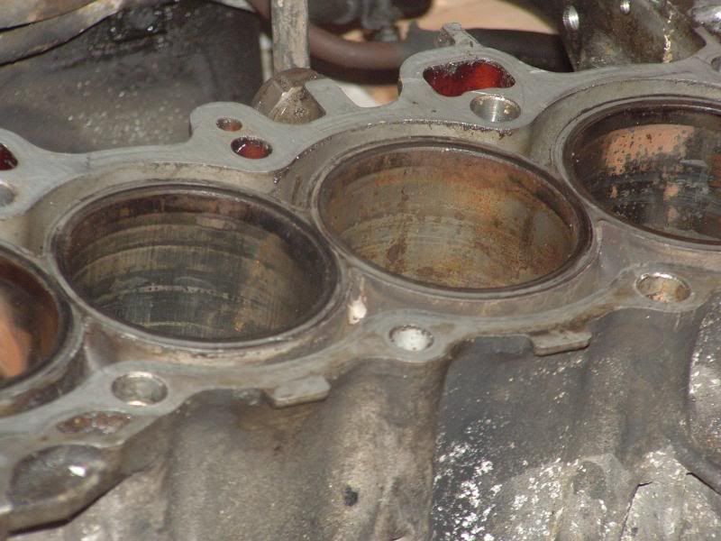

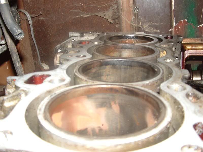

is my bolck sleeved
kermit5327
Member
if i was to post up pics of my block would anyone be able to tell me if its sleeved
cuz they guy i got the car off of said that is was but he also said that it was it ran low 11's in a quarter on a stock boosted y8
i dont think so..and that guy is a liar,,no stock boosted civic will run 11's in quarter mile,
probably low 14's to mid 13's
ok thats what i was thinking and yeah i know the was full of shit lol i knew it when i bought the car caz of the shit he said lol
Judging by the looks of the sleeves... no closed deck... They look like oem sleeves, but the short block was used, so I would measure the sleeve thickness and compare it to the stock measurement and see what you get. If its thicker, than its sleeved with an open deck and just simply looks like shit. :thumbsup:
There is no way that block is sleeved. You can see the two different materials the aluminum alloy and the steel liner
