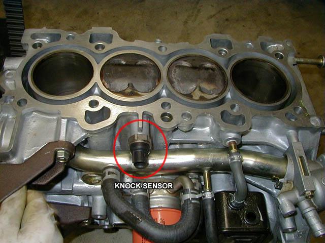

  6. eg6sir
    21,691
    your knock should be above the oil filter, near the head.. the one below the oil filter is the oil pressure sender maybe, .. something like that.. check and see if you have above teh oil filter, right under the intake mani.
    this pic is of a b18c, but it should be in a similar location.. i think you have it plugged in the wrong spot

    yo much thanks to eg6sir vbmenu_register("postmenu_782414", true); , you were absolutly right, thanks alot, no check engine light, everything perfect, thanks again everyone for the help.
