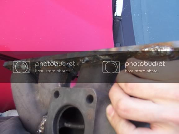

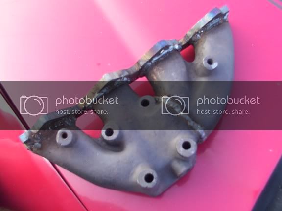

    Look into engine managment @ www.pgmfi.org , it dicusses how to go about it and save a bunch of money compared to systems like hondata or AEM. For a manifold it is possible to modify the eclipses manifold that is what i did, i have yet to mount it but it should work.
    You can see where i cut and welded, it is a matter of using the engine side off the b18 removing 1/4-1/2 inch between runners on the manifold.
