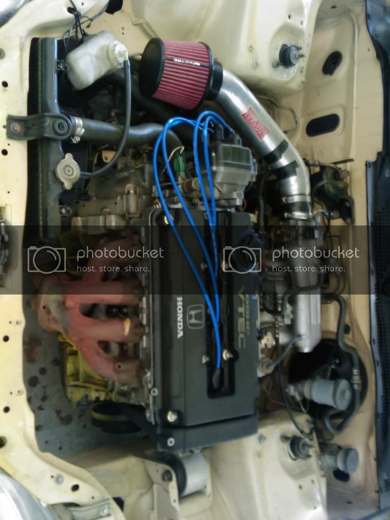

And bakerderek0, I'd love to see some pictures of the EG w/B16 if possible. :)

Glassheadlights - Here's a pic of the engine bay. All of the work you see was done by the previous owner, except the sparkplug wiring and air filter. The whole car is painted that pheonix yellow color.
