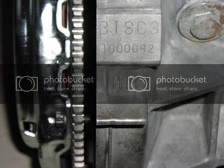

I feel so dumb, i went to my local junk yard to look at an Integra. But when i got there (after an hour searching for the car) I found it and realized i didn't know how to tell what kind of engine it is. =( I looked fro that stamp next to the intake but couldn't find it. Is there an easier way? I want to go the "Harry's u pull it" near me where they have thousands of cars and they sell all engines under $100. So i really need to find some way to reconize engine type
If you look at the exhaust manifold, its on the left side. Right where the block meets the tranny. Its on a little flat pad, and most of the time its got shit built up on it so its very hard to read.
It will be on the block right where the tranny mates.
ok i just went outside and looked my engine over. Found the place completely covered in shit. Wiped it off and it read D16Z6. thanks man.
ok now that i know how to tell the motors apart, which B18C should i be looking for? the B16c6? or should i go for an older model?
You should look for the b18c1, which is the GSR.

All the stamps are in the same place.

Since you obviously dont know very much a great way to tell motors apart by the abbreviations B16, H22, D16
Is start with the letter, where going to use a b18c1 throughout this.
B18c1.....so its a bseries so you would need b series mounts for an install
B18c1 ... 18 whats that it means its a 1.8 liter
B18c1... c-class(pretty sure) which means its not a ls(pretty sure on this)
B18c1... 1 is the trim, 1 is gsr, 5 is type r
