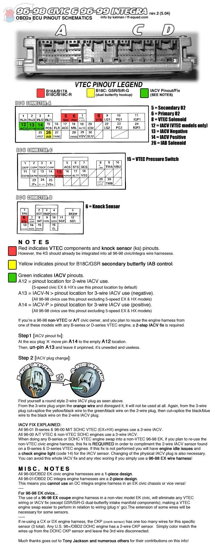

    the ecu looks like the obd-2 ecus with 3 rows of pins it looks exactly like this [​IMG] and says p28-ao2 and the dizzy plug is a 1 plug dizzy also. i can take pics if you want??

    probably took a asticker from a p28 and put in on a y8 ecu.
    ao2 = usa. thus, you can't even get around saying that its from another country.
