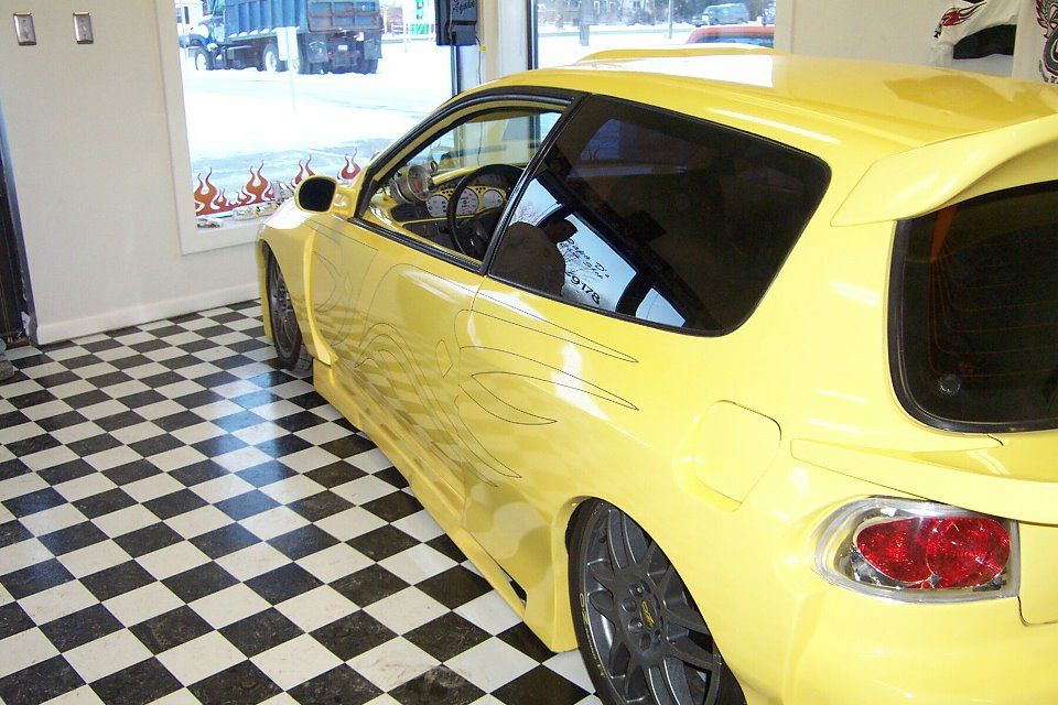

    Will do, Love the car quite a bit, this is my second hatch, the first one my friend and i did the swap, i suppose that makes sense just a weird ecu to just happen to have, its not USDM, i already ordered another one so i will probably just get a tuned p28 later once i have more of the car setup the way i want. I posted an album of my old EG, i will post EK pics once im home and on my own PC!
