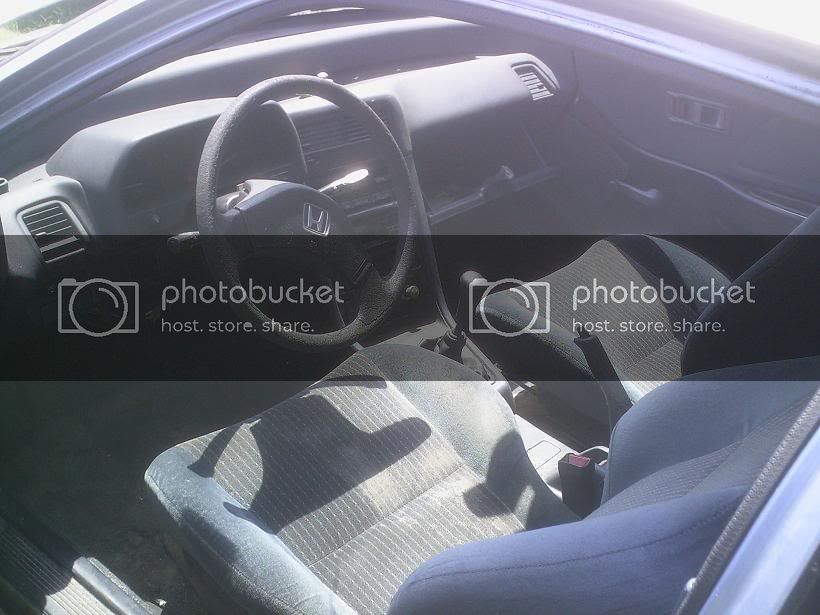

pull up the carpet by the drivers seat and see if the rott is bad, and pull a few of the fuzes and see if they have corrosion on them...if they do...then good luck getting a clean title for it, cuz it's prolly a flooded vehical from somewhere...try to run the vin on that vin thingy to see what the prior history of the car is.
other than that...it looks like a lot of work ahead of you if you plan to fix it up.
Well the guy said he's had it for a while, but idk if he got it from a place down in LA or w/e. he IS Mexican, so it's possible he got it for real cheap somewhere.. (and sorry for the stereotype, but he had like 10 cars in his yard.........) I was kinda suprised to see the gauge cluster filled with moisture though..
Anyway. I don't think it's been flooded, but I'll definatly check out the stuff under the carpet. see if theres any rot and mold etc. maybe the cars just from the north where it snows?

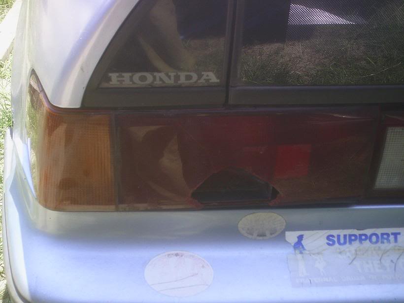

what threw me on that was the pic of the gauge cluster....and the broken taillight. The Z I just got sat outside with no drivers window all fall, winter and spring...and there is nothing on the dash...if there is something on the dash, then more than likely its flooded. Just walk away....if you see any signs.

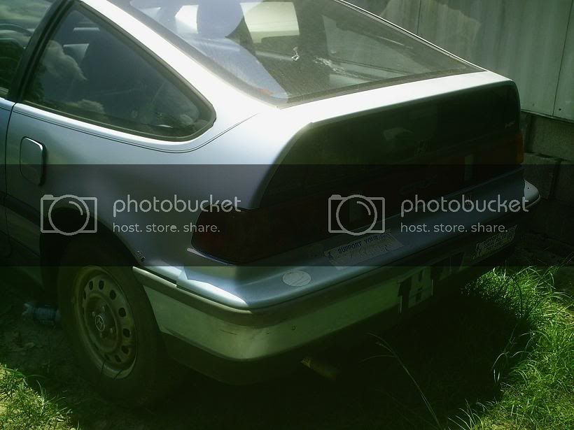

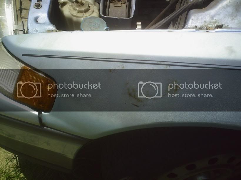

that car has sars. all that rust and shit. it will cost another $1000 for paint and rust repair, unless you can do it yourself. that would make it over $2000 including tax. you can find a clean crx for that price if you shop around. low ball the hell out of him. if he has 10 cars. he'll let it go for $400. not a penny more.
Yeah, honda pannels are thin. Rust becomes holes..
That rear rust is a pain in the ass to fix, fenders are easy as hell, hood too.. But why do all that paint and repair and spend the $$$ when you could just buy a clean one?
If you're looking for a project car, have at it, but a daily driver? I'd keep shopping.
And yeah, offer him $400 and go from there. Probably pick it up for 6ish.
