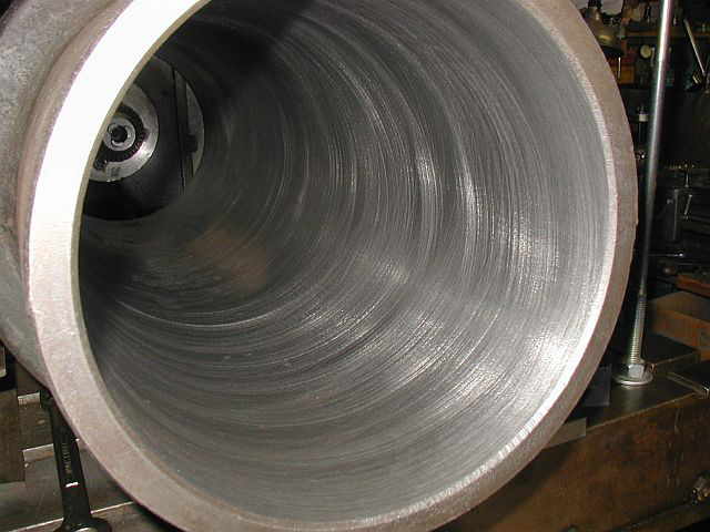

Have another question. I honed the cylinder walls out awhile ago. Someone had recommended (I think on this board) that I hone it right before I put the motor back together incase there is any slight surface rust. What do you guys think about that? It looks ok at the moment, but its already been honed, just not sure if you can do it to much or too little?
I had forgotton we had a parts washer at work. Honda engine blocks being the nice size and weight they are fit right into the bin. Took all the oil, grease, carbon and whatever off the block without using any acid or water. Took only a few mins. Incase anyone is wondering a bare zc block with nothing attached to it only weighs 40 lbs.
I have another question though. Someone looked at the hone I had done to it. He didn't think it had a great crosshatch on it. Is this something I should really worry about. It looks fine to me and feels mildly rough when I run my finger over it. Whats the worst that happens, the rings don't seat and don't last as long?
Kinda looks like this, I'll see if I can get a picture later. This is off another website I found.
Well, I guess thats one thing I'll have to take a chance on. It is my second car anyway so if it breaks, not a huge deal. The walls are slightly rough, not deaply scorn. I'll have to let you know how a "bad" crosshatch works out in the long run.
