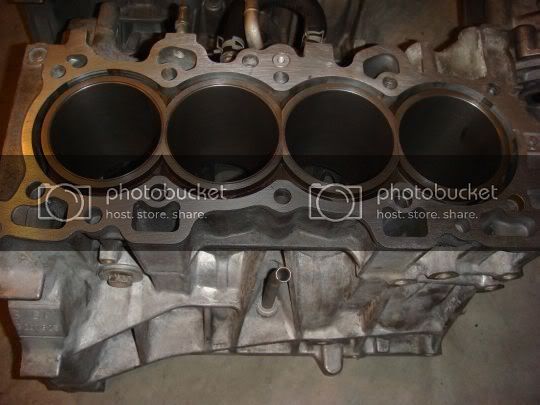

    I was looking at other forums and I saw someone installing "sleeves" what are those and what is their purpose?

    in this picture:
    the four circles joined together are the sleeves.
    that is what the piston sits in and up and down.
    the combustion happens inside this little metal condom and like a condom keeps that combustion confined to a predetermined area. lol.
    at a certain point, when you put higher compression pistons in, or are force feeding more air/fuel/nos into the cylinder, the amount of pressure becomes too great for the stock sleeves to handle, and they can and most likely will fail.
    so, people put aftermarket sleeves in, ones that are designed to handle more power, and usually ones that are already oversized to fit bigger pistons, basically, bored out.
