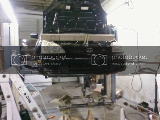

    sorry i haven't updated ya'll in a while. We got it finished saturday. It took almost a week to do. Everybody that we talked to around my small town all told us that the transmission would come out the top. ... There is not a way that the trans will come out the top, if you keep the motor in it. Finally we broke down and dropped the subframe. That and we had a clutch issue. He ordered a stage 2 clutch, and the clutch wouldn't fit his stock flywheel so we had to wait about five days for him to order the correct flywheel. We didn't have any problems with linkages or anything. He can go into reverse, but he said you have to push it over really hard.

  12. wolydotmatrix
    wolydotmatrix New Member
    10
    Feb 22, 2008
    what is that a 4" treated timber and a rachet strap?????? nice , use what you got:)
  13. wk_runner02
    wk_runner02 New Member
    30
    Jan 24, 2008
    Tennessee
    yup thats its.. It was like that for a few days, that was when we found out his clutch didn't fit the flywheel.
    We have one of the cradle things, can't think of what its called right now, on the way. Never thought that we would need one.
