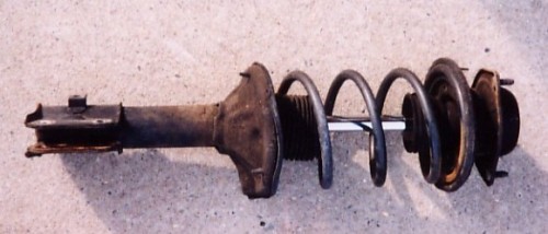

here is the stock suspension from an integra type R (the mounting forks are still attatched to the fronts) they are very similar to any other civic / integra... only difference is how the rear attatches to the LCA

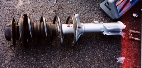

here is the Spoon non-adjustable coilovers
they are pretty much identical

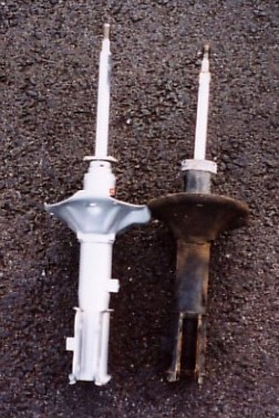

this is a strut
tokico has a nice simple explanaition on their page
http://www.tokicogasshocks.com/car/products.html
