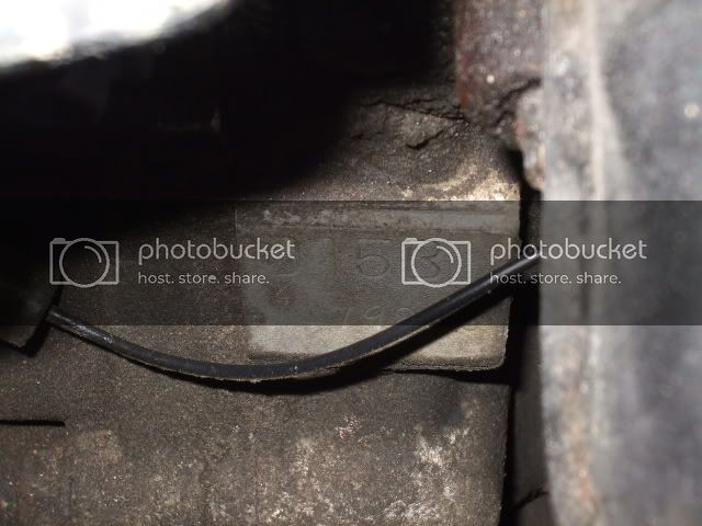

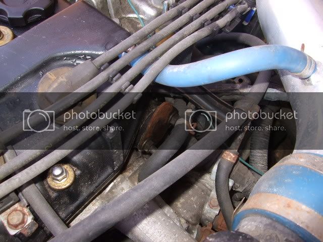

I bought this car off a friend. He has had the car for quite a few years, but I didn't know a whole lot about it.. not thinking it was anything special. So, when I went to look at it and take it for a ride I stopped and looked under the hood, obviously. It looked clean, sounded good, at quick inspection didn't seem to be leaking, it looked like a normal DPFI D15B2 or w/e is supposed to come in a 90 DX. I buy it. About a week later I go over and get all the goodies that came extra (EF9 sir seats,d16z6 head, etc) and he is telling me how this car has some JDM Vtec motor in it. He is a bit of a talker sometimes so I thought he was bullshitting me and procceded to start to call him out. I mean it is DPFI manifold and all. Well, we cleaned the stamp of and it is a D15B with no other number. I know there was a DPFI D15B that came in an old Japanese 88 Civic/CRX and was obviously non vtec. Here is the weird thing, there is a block off plate on the head where a seleniod should be. It's probably just be the non vtec DPFI, but why would it be like this? I wouldn't think an OBD1 MPFI could run with the DPFI manifolds,wiring/plugs,etc. The pics I could find of the Vtec d15b also have the plugs and wires/oil cap reversed. The kid my friend bought the car off him told him the stuff he told me. WTF is this thing? I also need to take off the heat shield to find out what is stamped on the head. No time today.
unless someone swapped a shittier head onto a vtec d15b bottom end, then it's a jdm non-vtec d15b. not very common, but nothing special either.
Yeah, it's a d15b non-vtec... I have one in my 91 sedan. It's basically the same as the d15b2 as far as power is concerned. I think the block off plate is used if you run it carbureted... Oh, and the vtec d15b has the spark plugs on the front of the valve cover, the opening for the vtec solenoid is much longer, and they usually say 'vtec' on the valve cover.
yes, that D15B is from a 88-91 JDM Civic/CRX and was available with single carb with 90hp or dual carb with 98hp or dual carb with 103hp - the block-off plate is where the mechanical fuel pump was located - if you look at the camshaft, you will see an extra lobe which ran the mechanical pump

Ah, I see now. I figured it was just the dual carb OBD0 but that hole with the plate just made me curious. Thanks for the info.
