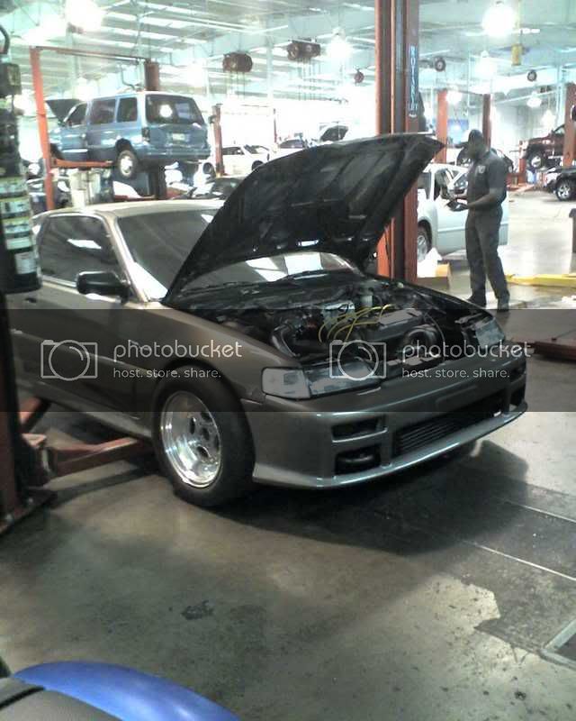

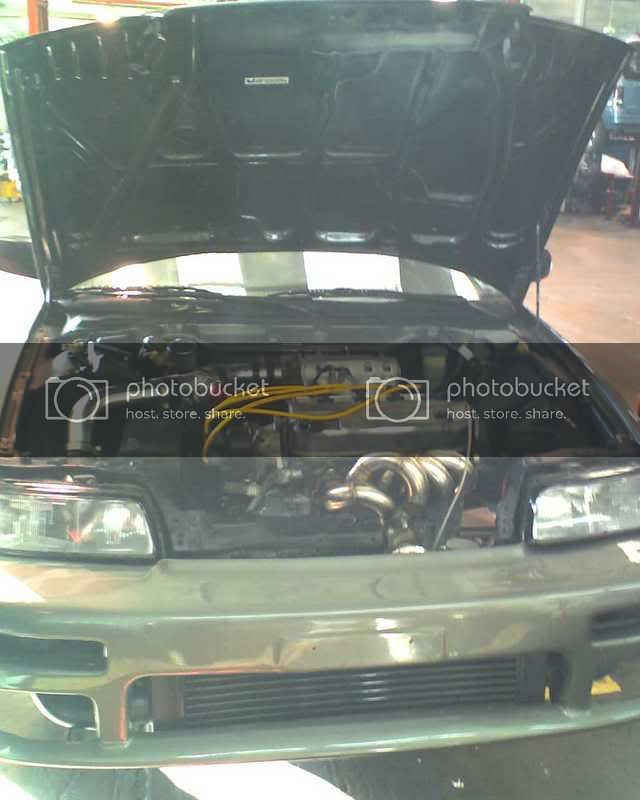

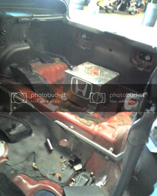

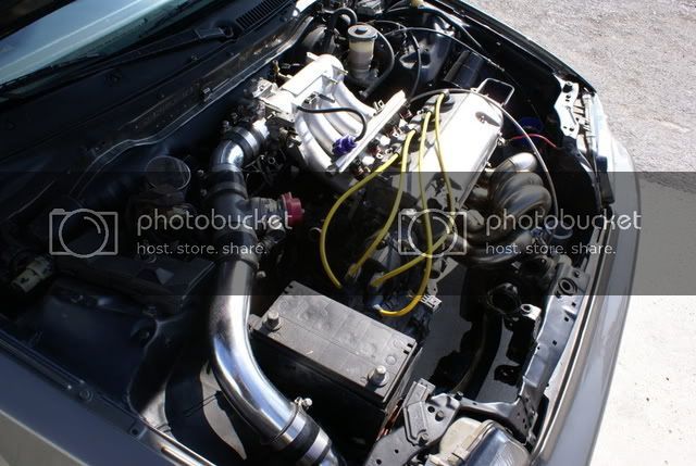

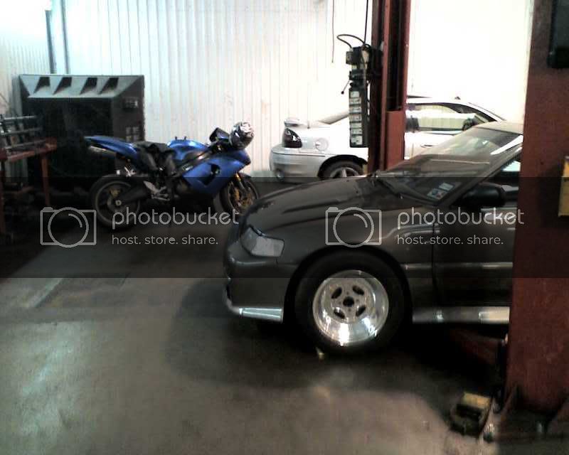

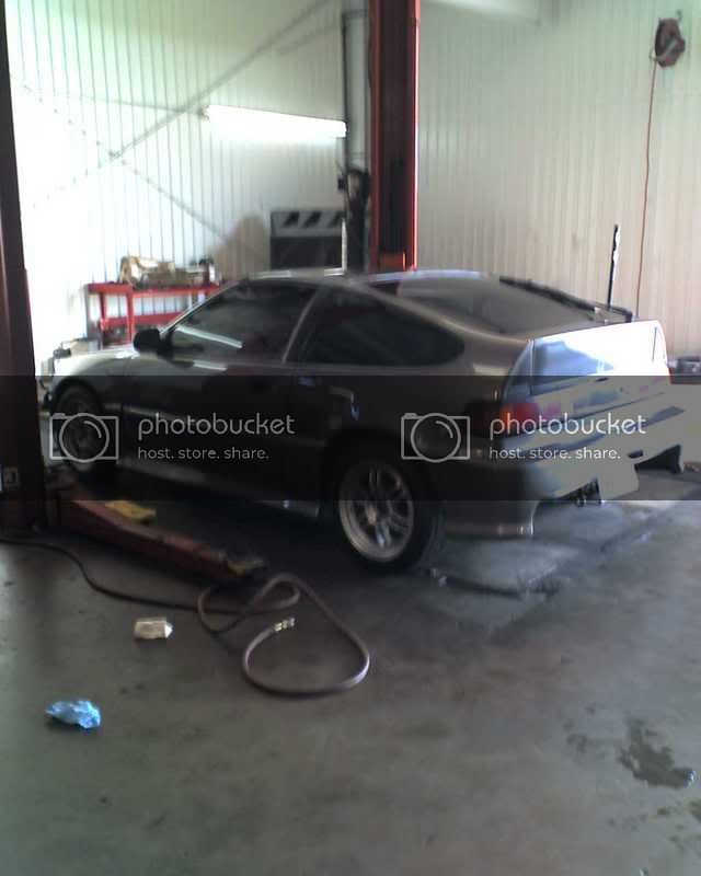

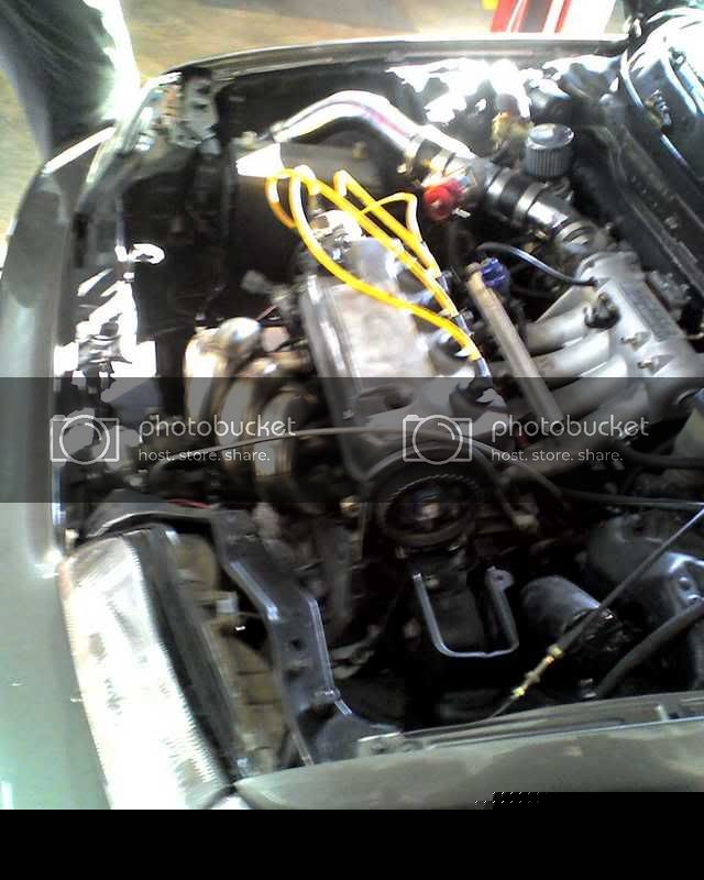

    10/30/07 Progress: The fuel cell is in, fuel system is done. Got my injectors about a week ago, scored a set of RC 1000cc's for super cheap. The bottom end is done, the transmission is done, and the bottom end/transmission/clutch/axles are in the car. Today I finished the suspension (skunk2 drag launch springs), removed the oem sway bars, and started pulling the interior.

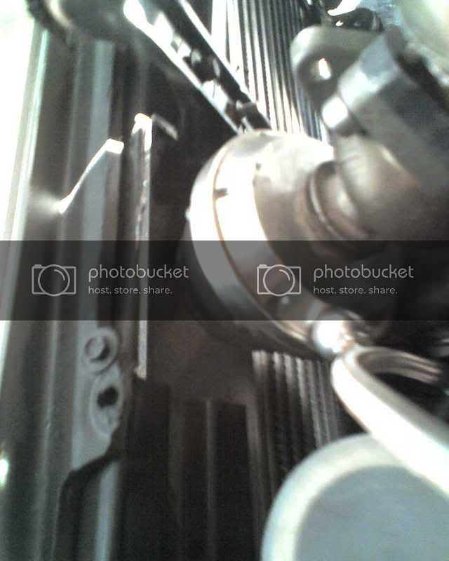

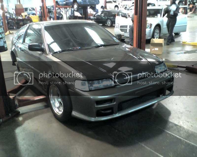

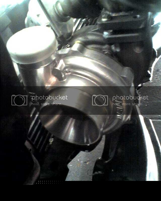

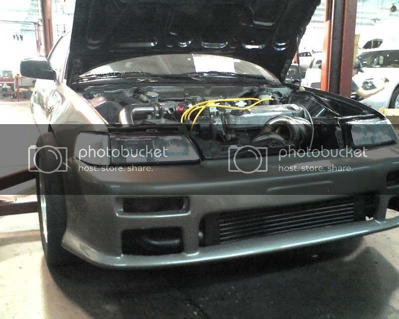

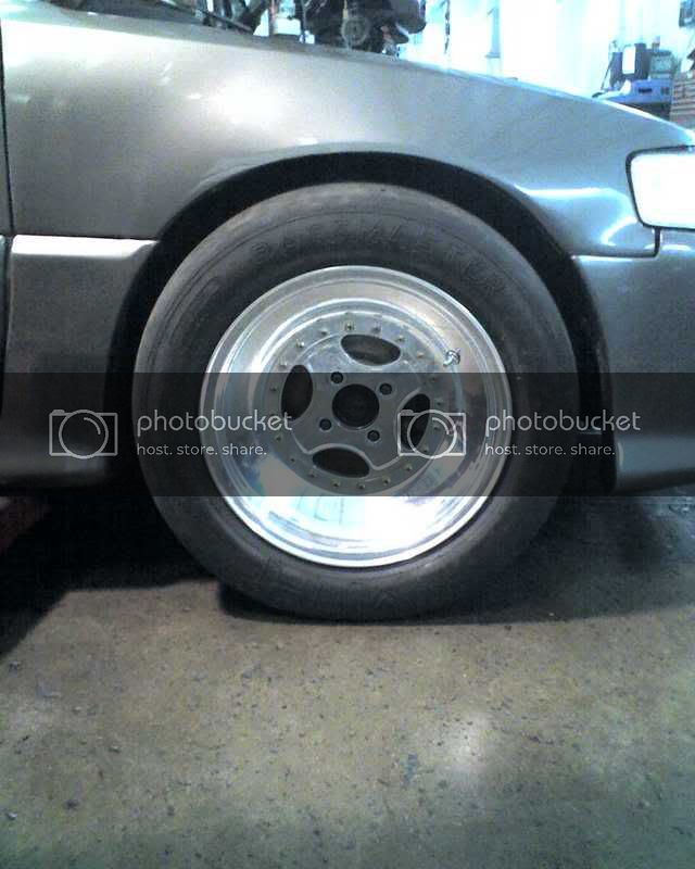

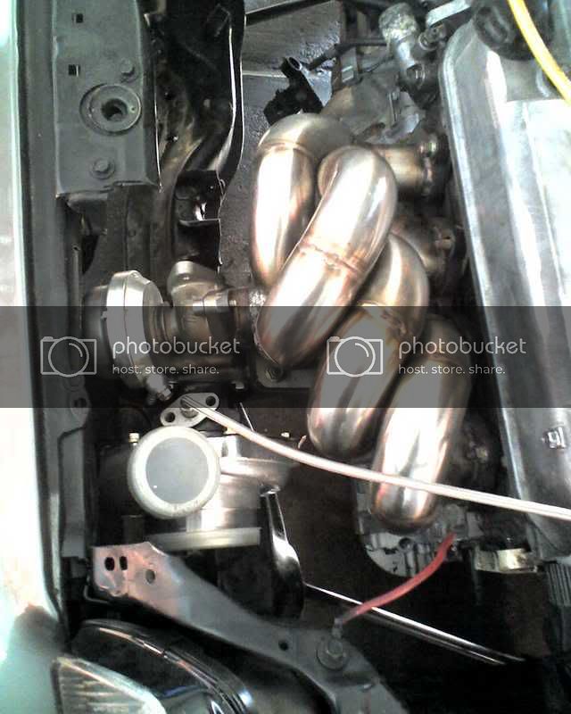

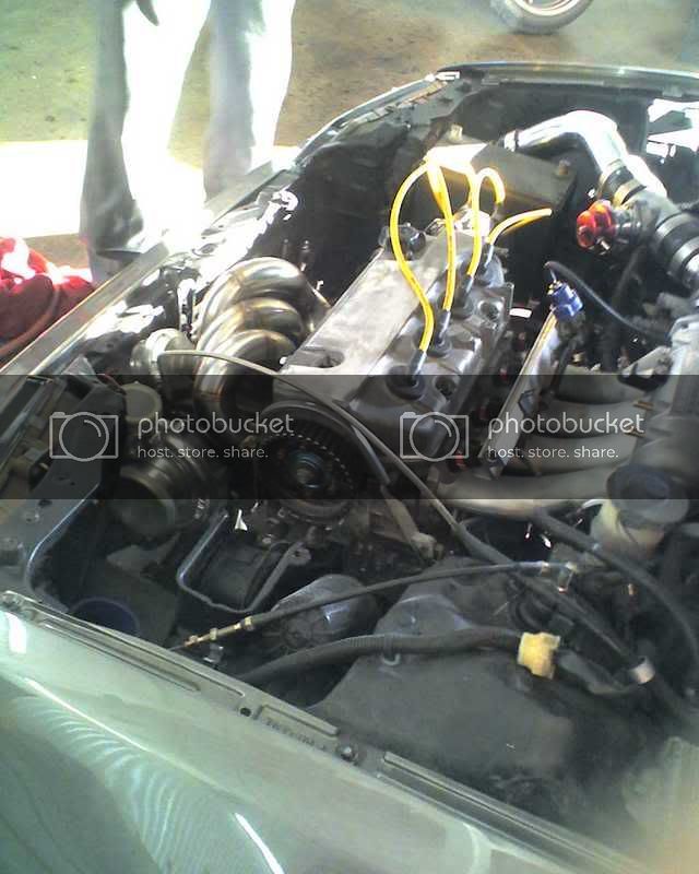

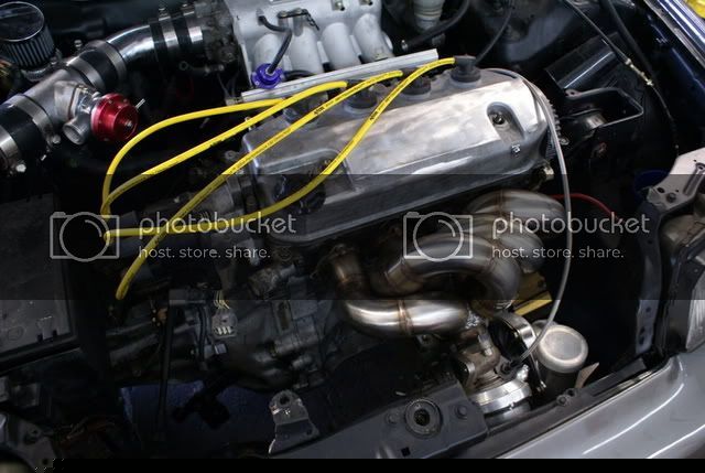

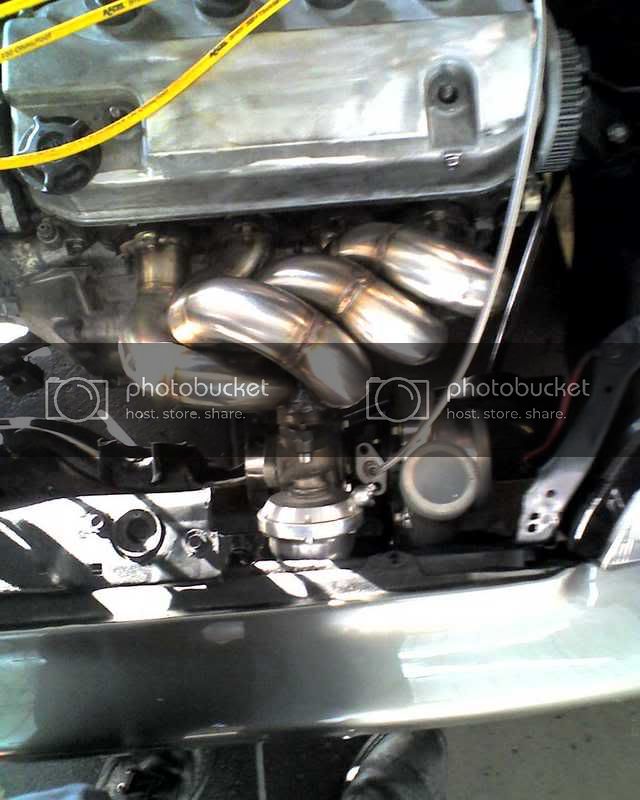

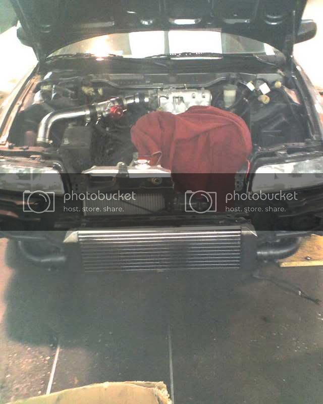

    11/29/07 Progress: Got the intercooler mounted, all the piping cut, got a manifold that's going to work. It's a copy of the Ebay 'Blurr' manifold. It sets the turbo out a little bit further than I'd like, and I had to trim some of my homemade bumper support to clear the wastegate, but all in all it's going to work. The suspension is finished, the fuel system is finished, all the piping is finished, and the front end/bumper/etc is all mounted and ready to go. I also got a set of Bogarts with M&H 24" slicks in and put on today, and my RDR skinnies and tires should be here next week. From this point, I only have to get the head I'm going to use put on (it's still off being ported), fab up a downpipe, pllug the harness in, and get it tuned. Should be running before new years!

  4. boostedf22
    boostedf22 dis is why im not
    1,581
    19
    May 28, 2007
    in the land of OZ
    Looking good man, NICE BOGARTS.....
    That motor built ? Whats the HP goal ?
  5. civicious
    civicious FüK-VTEC VIP
    9,881
    648
    Jun 15, 2003
    Houston, TX

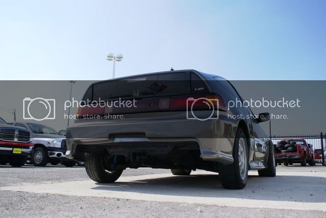

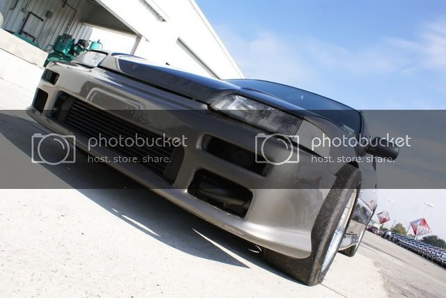

    The motor is fully built. I'm looking for somewhere in the 400+ hp range.

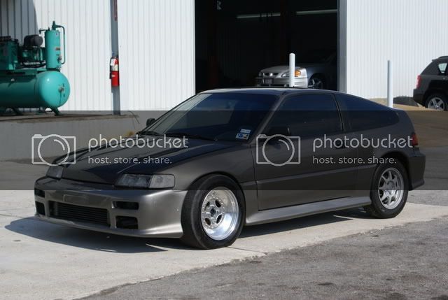

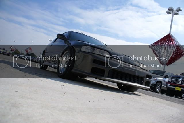

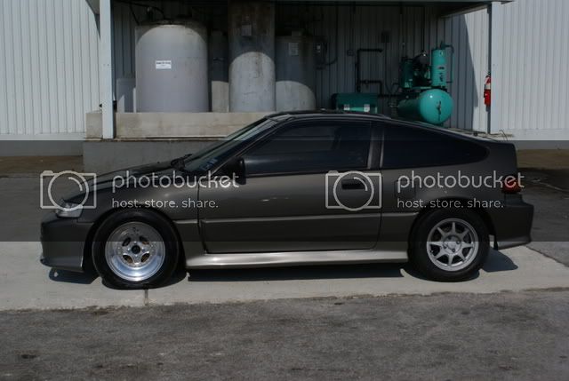

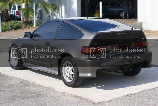

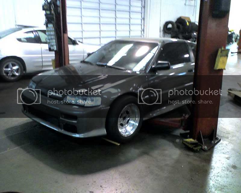

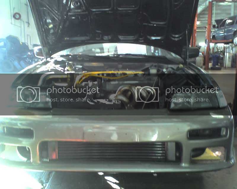

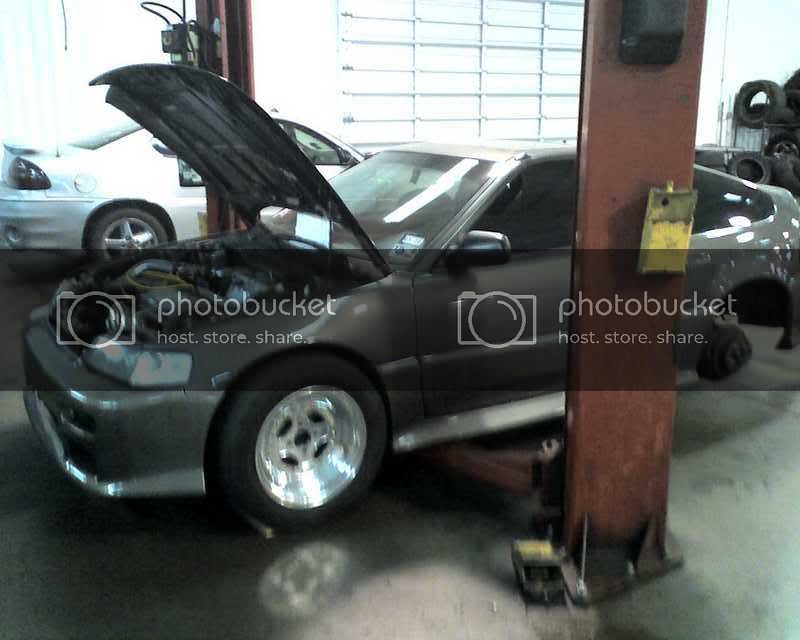

    Borrowed some HX wheels, rolled it outside, and took some better quality pictures. Betcha can't guess what kinda dealership I work at!
    I really need to properly adjust my suspension, but I'm waiting until my 15x3.5's come in next week to mess with it.
  6. daveholiday
    daveholiday Do work
    1,820
    47
    May 10, 2007
    Pittsburgh, Pennsylvania
    Gorgeous, to be simply put.
    BTW, I bet you work at a Dodge dealership ;)
  7. norcalgsr
    norcalgsr Honda Master Technician
    1,168
    17
    Oct 10, 2007
    NorCal
    I know what dealership you work at, but you already told me lol..
    I absolutely love your car :D

  9. 93civicracer
    93civicracer Oh, I do a little here and there.
    2,116
    18
    Apr 25, 2007
    Texas
    I like the turbo manifold :D.

  12. LS_VTEC
    LS_VTEC you get the BRAKE
    2,613
    25
    Dec 11, 2007
    NJ
    Nice shell... love the bogarts... I have the Lenso's... not shiny like your's, im jealous ;x Judging by all the Dodge Ram Pickup's in the background of that picture, you must work for Dodge... I'm sorry to hear that.. J/K =) I'm trying to get into a Honda Dealership right now but noone is looking for technicians... so I have to pretty much wait for one to quit or get fired and the list moves on... Good luck with the tune..400 should be possible with A LOT of boost. my sohc vtec turbo setup that was in my coupe made 190 @ 9psi (T25, stock engine).
