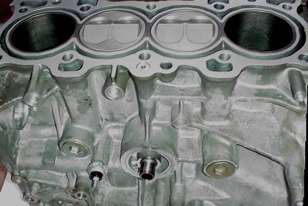

You are right in thinking there are some replacement parts for the "black box". Endyn makes a complete setup for around $165. Or you can do some research and do it yourself for a little cheaper.
Basically you remove the black box, and put a brass plug in the hole it makes. Take out the two big allen plugs on the back of the block and use prelude fittings as hose outlets that run to the catchcan.

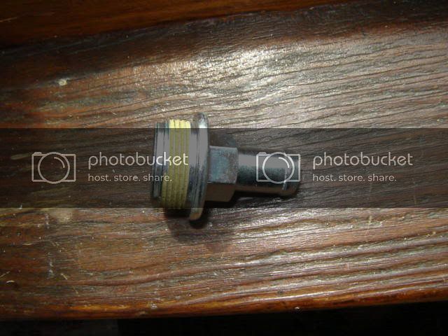

Are you talking about tehse huge hex head bolt things
yep those are them, heres a pic of the replacement part. PN 11107-pk2-003
