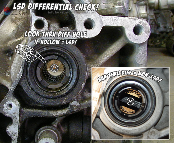

    how do u telll if u have an lsd i heard if u leave 2 tire marks when u do a burnout that u have an lsd??? true or false

    dam im not trynaa take my shit apart likee that no time for alll that

    I think that if tou put the tranny in neutral and spin the wheel, if both wheels spin the same direction, you have lsd... if they spin opposite, then you don't.
    In my mind, this should work, but maybe someone can verify this.

    your right, just jack up the front, if the tires spin the same direction, you got lsd, wheels spin opposite, no lsd. takes under 5 mins and you dont even pull the wheels off
