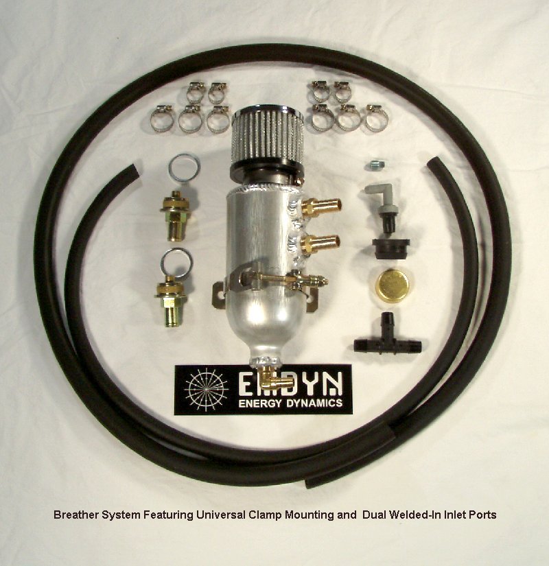

the pcv valve is a valve that allows blowby gases to escape and go into the air intake to be burned up. A catch can catches the oil and re diliveres it to the oil pan. Cusco makes one. I swear I saw a diy one somewhere I am trying to find it.
http://theoldone.com/components/breather/
very worth it. there are tons more on the market.
