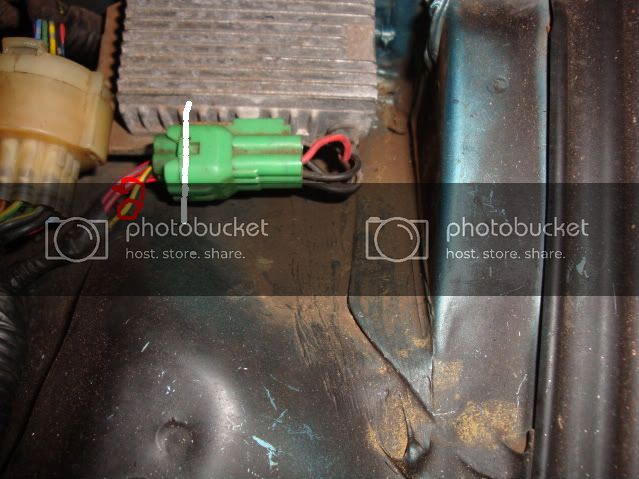

    That would work, but your car should already be MPFI so yours would already be set-up so to say. You can swap over to the OBD1 connector so you can use that jumper piece, or simply just splice and solder all four power wires to the injectors together, and connect it to the hot wire that goes to the resistor box.

    so it goes like this:
    change the obd0 injector clips to obd1 clips by soldering the wires
    remove the resistor box
    then connect the yellow/black wire (guessing thats the power) to all the 4 red/black (guessing thats the power going to the injectors)
    this should be all set?
