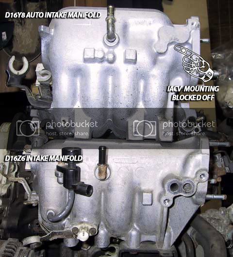

    I found this btw...

  20. 97hatch
    97hatch ?
    1,693
    20
    Feb 6, 2003
    Anderson IN
    you cant just drill them out one of them is a port that goes to the tb and the other to the intake plenum. trust me you would need a mill not a drill to acomplish this. thats why i said a automatic manifold wont work
