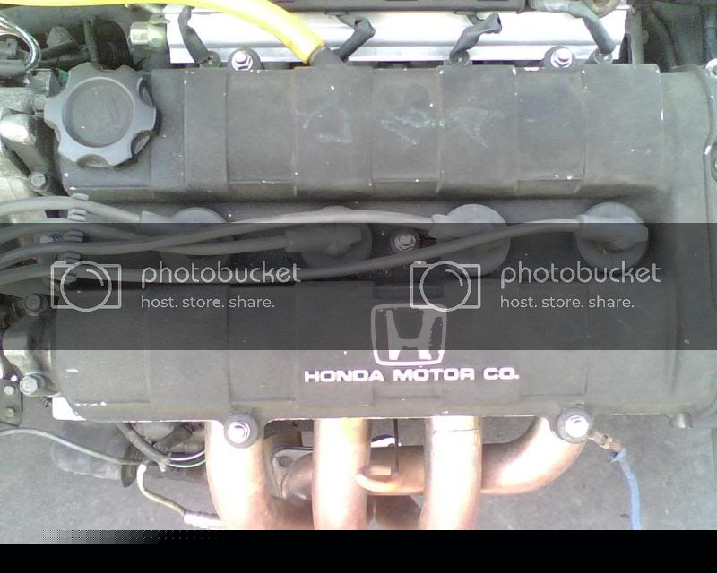

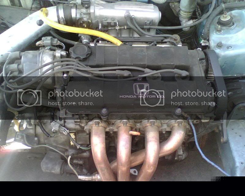

    and this one is the zc engine i have

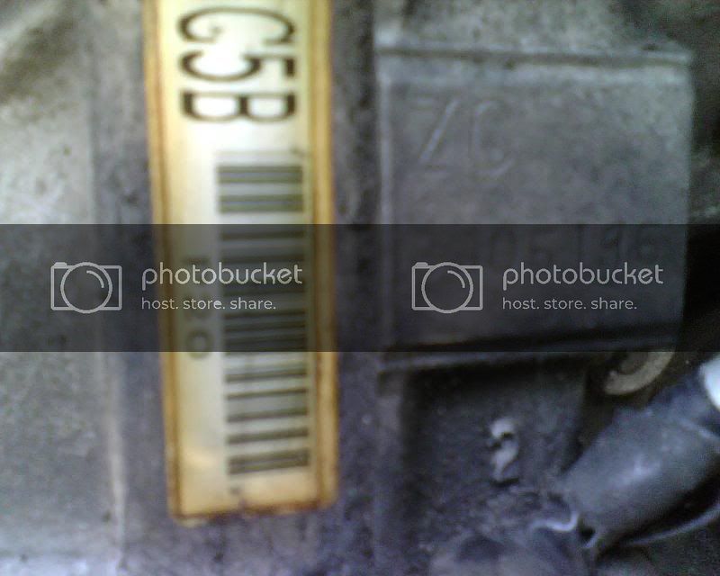

    this 2 links if the trany i have idk if work a lil bit

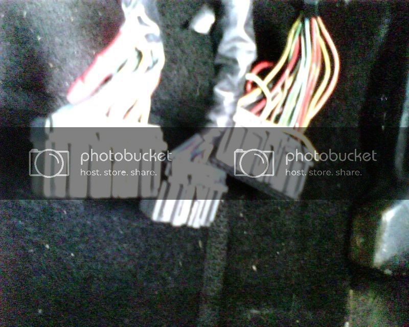

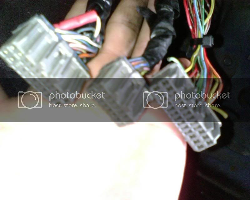

    this is the cable that go to the computer

    okay but i need to remake the wiring or something if i get the p29 and were can i get it any store need to order by internet but u said get it chipped were can i get it from ...i just post new pic of my zc and the pins cables of the computer
