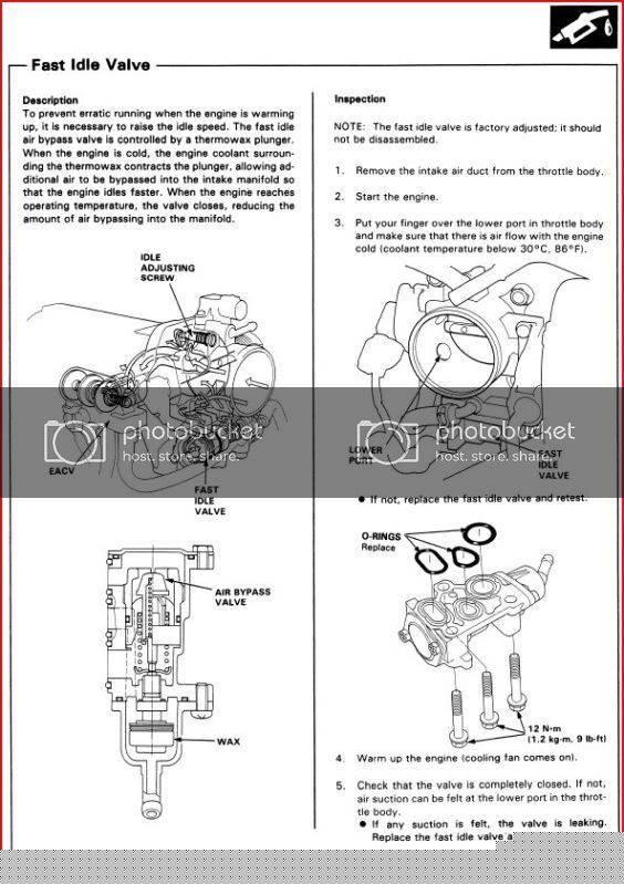

I can't adjust my idle any more on my civic and need some ideas. I changed my failed solenoid Electronic Idle Air Controle Valve "EACV" after it was humming. The only parts I have not replaced on the engine and power train systems are the Fast Idle Air Valve "FAV" witch is located on the bottom of the throttle body and havn't replaced the distributor body, egniter, coil, and spark plug wires. Everything besides the piston, piston rings, oil pump, bearings, and crankshaft are new.
I need to adjust my timing only after I have the base idle set. I currently have the timing set by holding the throttle to the proper idle. And basicly I need more rpm and my adjustment screw is all the way unscrewed. "I did unplug the EACV and reset ECU after attempting to set idle and finding problem."

Tommarow morning I will try and swap out my 115k mile old Fast Idle Air Valve with a 40k mile old one that I have as a spare.

I replaced the fast idle valve and advanced my timing. I got my idle solved but still have low vacume and retarded timing. I can't adjust the ignition timing any more. I was told that it is a valve problem because of the vacume results. I did notice a valve spring looked week witch came assembled on my rebuilt head I got from ebay. I think they mis-matched a spring. Any ideas if I should simple replace that spring and adjust valve gapping when engine is hot and if that would fix the vacume problem? All hoses are new, new pcv valve, and new gaskets with seals. The distributor is not new and may need replacing along with spark plug wires.
