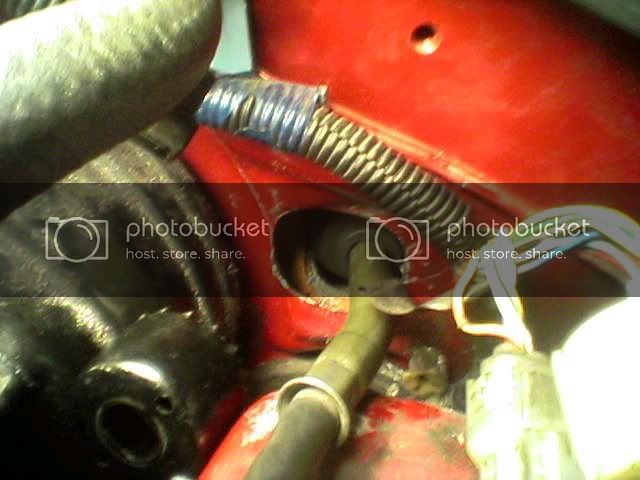

so the problem is now..... its working (i think) but that little rubber peice that hold the clutch cable into the fire wall.... it popped through my hole... but it seems to work tho... any ideas??? and i have pic.. photobucket?

don't know what to tell you about the firewall peice/grommet/thing.if it won't stay, could you epoxy it or something? somehow attatch it?

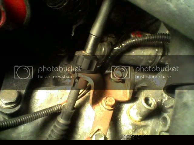

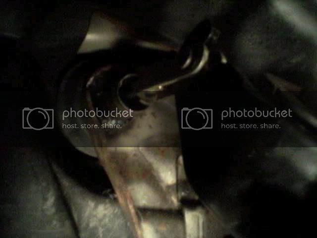

ok well its not goinmg to stay like it looks like my clutch is going to have to work the way it is bcus its like an inch to short for some reason and now with that peice through the firewall it looks like it might work just becuase of that check it out <a href="Image hosting, free photo sharing & video sharing at Photobucket" target="_blank"><img src="http://i42.photobucket.com/albums/e307/pimpinsmythe69/untitled.jpg" border="0" alt="Photo Sharing and Video Hosting at Photobucket"></a><a href="Image hosting, free photo sharing & video sharing at Photobucket" target="_blank"><img src="http://i42.photobucket.com/albums/e307/pimpinsmythe69/2.jpg" border="0" alt="Photo Sharing and Video Hosting at Photobucket"></a><a href="Image hosting, free photo sharing & video sharing at Photobucket" target="_blank"><img src="http://i42.photobucket.com/albums/e307/pimpinsmythe69/1.jpg" border="0" alt="Photo Sharing and Video Hosting at Photobucket"></a>
maybe get a peice of metal, drill a hole of the correct size in it, and either weld/epoxy/something it to the firewall over the other hole. maybe that would solve that problem. it's hard to see one of the other pics, but it looks like you have the cable in the bracket correctly. i'm going to assume that you have the ball at the end in correctly. so, it looks like the only thing that's not right is at the firewall. if when you get that fixed, it's still too long, then i would say it's the wrong year cable.
