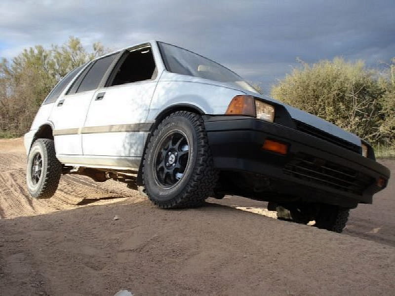

bammmm peanut butter and jamm truck tires on hx wheels lol its torsion bars in the front soo easy lift and springs in the back - boom spacers its a lifted 4x4 honda with more power than a suzuki samuri

85 Civic 4WD Wagon.
