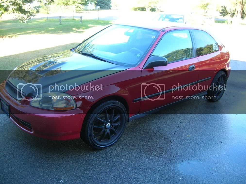

    what no why ?/ lol show me some pics of your car. can i suggest gettin a bigger motor and converting to obd1 , it'd be nice.
