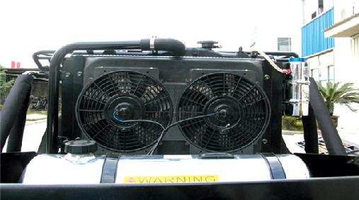

    22R with a Volkswagen tranny. The front suspension is off of an hold BMW and the rear setup is from a VW Bus. We are trying to work out a diffrent air cleaner setup and radiator position as well. It isnt cooling all that well and the first motor that was in it got trashed by the original owner driving it with a sub par air cleaner on it. Sand in combustion chamber = bad news.

    22R is in fact carbed. Toyota put the 22R in a shit ton of rigs. We have to fashion up some new mounting brackets for the radiator. The original owner thought that putting it on the side of the engine cradle would be a great spot, he was incorrect in that assumption haha.

    Go with something like this, this is where Ive seen most all of them on the buggies that are water cooled (boo air cooled is the best:D) right behind the seats with a high CFM push/pull fan.

    And that is the kind of radiator setup I had in mind too efhondakid. I really want to put a dual core aluminum radiator in it as well.
