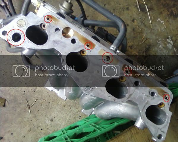

the image below is of my intake manifold. i was told it was from a manual 2000 civic ex, so i'm guessing everything circled in red is what needs to be plugged. can anybody verify this please? also, do all of these NEED to be plugged since i'm still using the same y8 head that this manifold came from? thanks

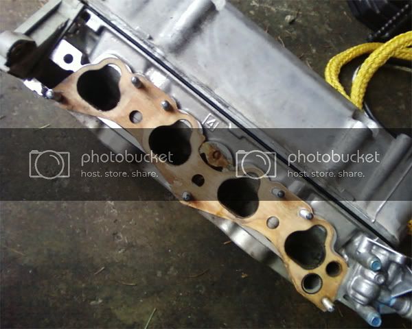

and here's a picture of the head. upon more review, it looks like this y8 head's holes doesn't match up exactly to the manifold. is this head from a 96-98? thanks a lot

If you're runing the Y8 head and intake manifold you don't need to block anyting.
You will have to get the injectors off of the D16A6 Si intake manifold you have and put them on the Y8 manifold. It will make life much easier.

my manifold doesn't look like it came with that head. it looks like the manifold is 99-00 while the head is 96-98. can anybody verify that? i know i need to block off the air injection hole(s) but which are they? thanks

anyways, can anybody tell me exactly what all of the holes are that are circled in red? and tell me if i need to plug them up or not. because i can tell that nothing on the head is going to block those holes on the manifold. let me know please. thanks a lot
to be honest with ya i think those are coolant holes and if i were you i would prob go get the y8 intake just for ease of instalation. the other thing you wanna look at is when you do your swap and if your keepin the obd2 injectors ya gotta change the clips for them
that is the y8 manifold that's pictured. i was told to plug the top 5 holes but leave the bottom left one in the picture unplugged because that's for coolant.

i was also told that there's a date stamp on the head, i looked for a date and found "97". so now i know this guy was kinda bs'ing me because he said the head and manifold were together. i know it's bs now because the head is the 96-98 style while the manifold is the 99-00 style. either way it'll all work out, so i'm not too worried.

well if plug the holes cuz i have no clue where they go and as long as the coolant hole lines up you shud be good to go. and when you do the injector swap im not sure as to the fit the obd0 are a little taller if im not mistaken. and another thing is make sure you put a thin coat of copper spray gasket on your head, intake, and exhaust gaskets it will help alot.
