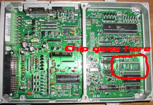

    pop open the ecu case. it should be pretty easy to tell if its been chipped or not.

    Yea it kinda is a hack job but I'll make her better.. I'll get the ecu case open later today and look.. I've been hella busy at work last 2 days but rest of my weeks easy.. FMU?

    Did not see any signs of aftermarket located in the ecu.. So I need to do some digging into chipping it and doing it on my own.. I'm mostly literate in computer tech so shouldn't be hard.. I'll buy an extra ecu just in case but my soldering skills are on point.. Now to the original post about injectors.. I have noticed since I got my tubing sealed up from intake to turbo and installed my digital controller that it still runs kinda rough during acceleration unless I'm about 1/3 throttle accelerating.. Planting my foot is when it feels like it chokes up like its getting too much or not enough.. It does smell kinda rich coming out of the exhaust but I've got an air fuel mix gauge on its way.. I've got it running on high about 10 psi and low 5.. Once I get above 80 it starts pushing 15.. And another note.. After about 15 minutes of driving it quits choking itself up.. Dunno what's causing it and have yet to check the code that gets thrown at me when it does happen.. I need to put a mirror or something down there to see what its blinking
