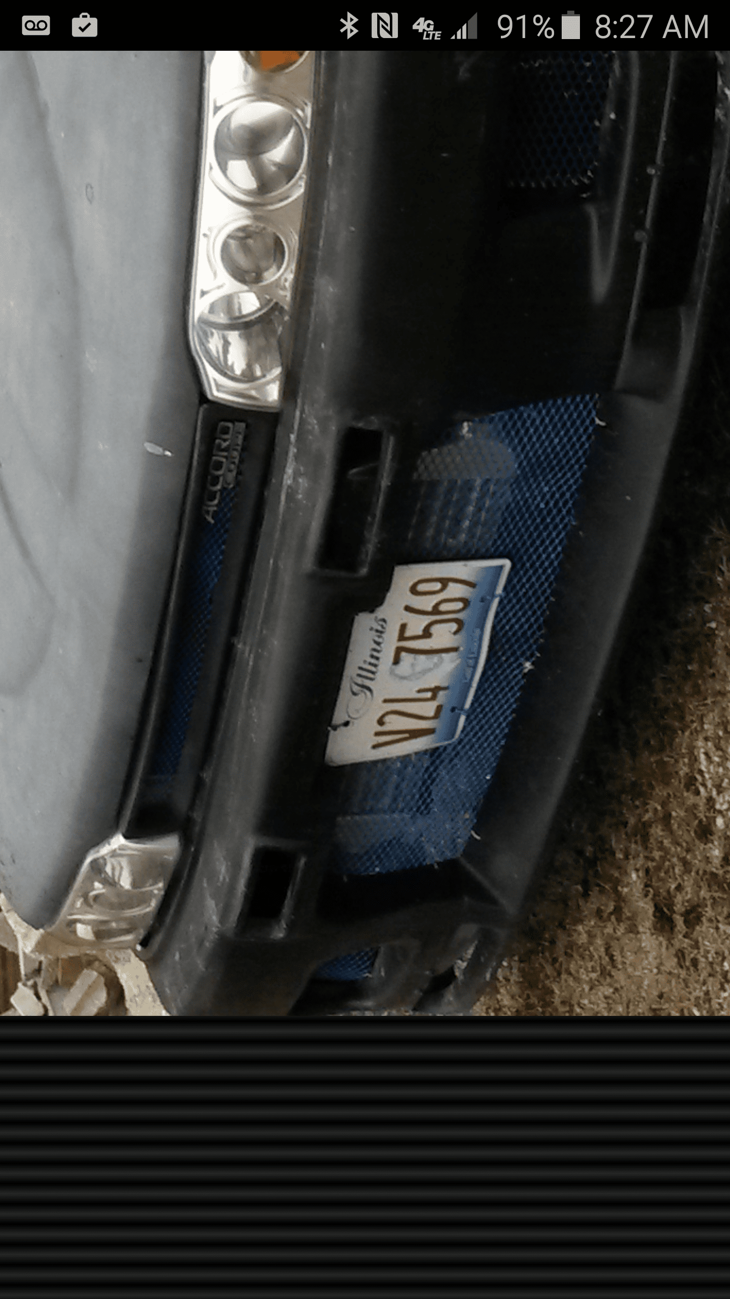

It looks like the intercooler is just sitting behind your chicken wire grill, sweet r32 bumper dood
It looks like the intercooler is just sitting behind your chicken wire grill, sweet r32 bumper doodView attachment 24613
Hey I bought it like this.. Lol. Only thing I've done is injectors 550cc turbo and 2.5 inch exhaust. Plus ARP studs.. Got new rods pistons and bearings coming n installed digital controller for turbo with 38mm tial bov and a 25 pound spring in wastegate.. Its still getting there.. Been searching for another cam to send to delta for a mild lopey idle concentrating on mid range is what I'm hoping for.. The body came like that... Dunno why previous owner actually cut the bumper under the cover to mount the intercooler rather than mounting it on the bottom. Recently gave it a street tune using turbo edit.. Needs to go to a dyno but I got it close
