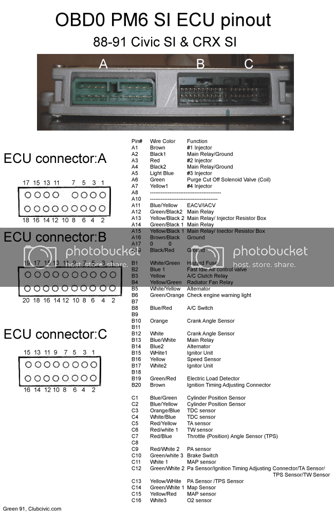

Well, I got the motor in, but I am not sure about the wiring. I have an 91 SI harness but like I said, I don't want to mess it all up, so I am looking for some aid on this part.

fail, and fail. his car is a dx and he said he has an si harness. you cannot plug a dx harness into a mpfi motor nor can you simply plug the si harness into the dx cabin harness. he needs to convert his dx harness to mpfi, using various pieces from the si harness, before it's going to plug right into the ls.
https://hondaswap.com/swap-articles/dpfi-mpfi-writeup-49557/
Check this out see if it helps you... That's if your going to stay OBD0?
