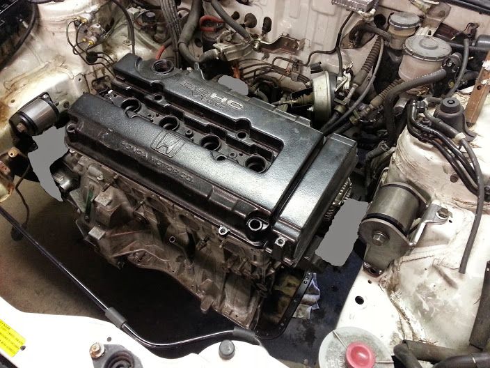

    Let me enlighten you a little on your 3rd Gen Lude.
    The most supported engine to swap into your Lude is the H22.
    I have now made the mount kits to support the swapping of the: B16 B18 B20b B20vtec motors with an S80 transmission into the chassis.
    I also figured out the shift linkage issue for this swap and can modify the shiftlinkage for you for a fee(please email me for info: 1funryd@comcast.net).
    Axle information is provided upon purchase of my B16 B18 B20b B20vtec swap mounts
    For more power you will either want to Turbo Charge it, or swap the H22 into your car.
    Let me help you with some info that I put together:

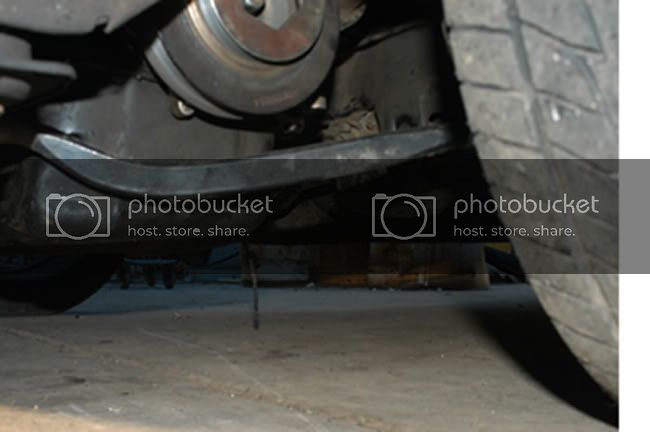

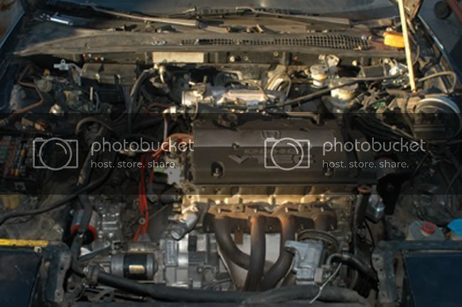

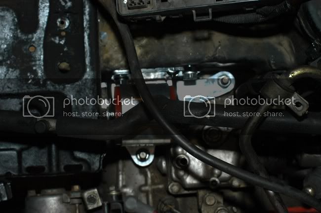

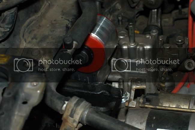

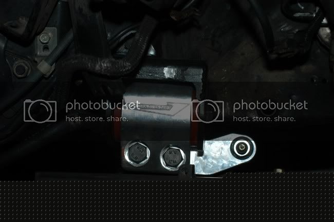

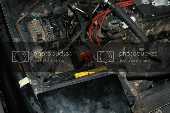

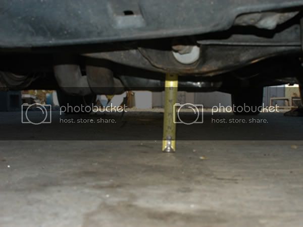

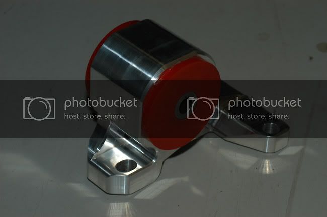

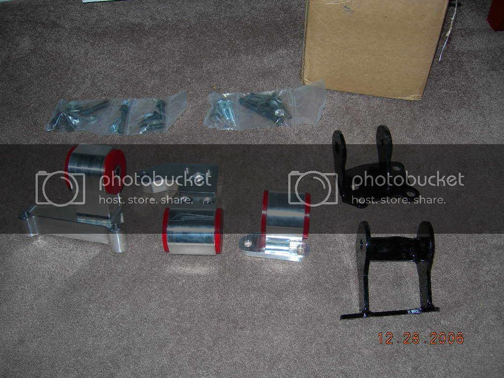

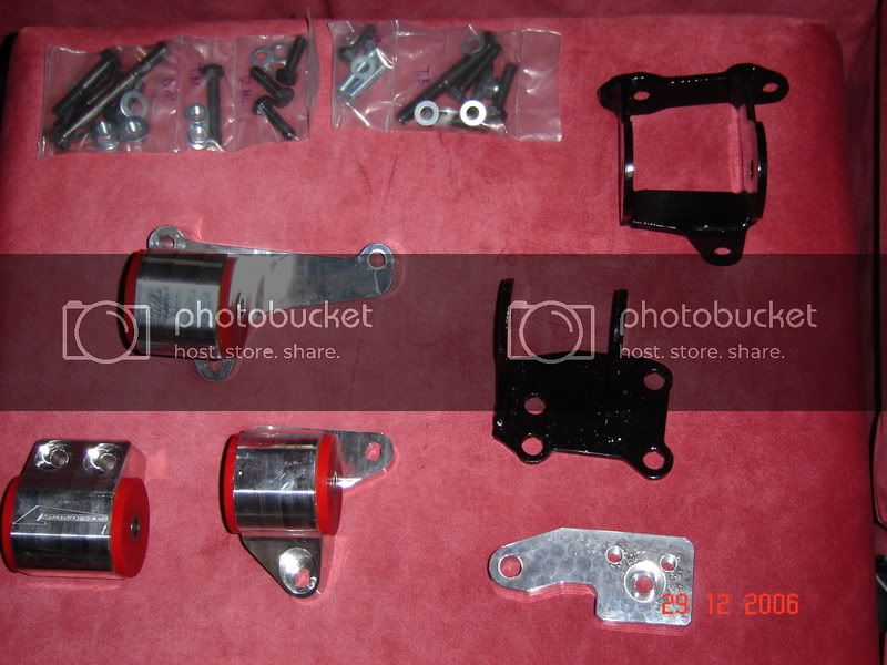

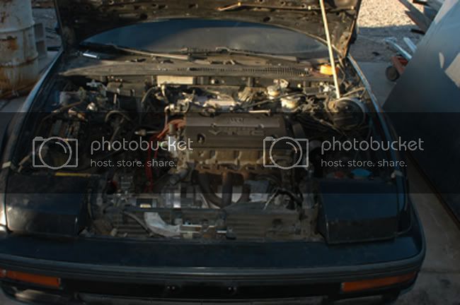

    This is what I was able to have produced for our cars. The H22 Mount kit
    Produced by www.1funryd.com - me
    Please note this is the project car, and is still under construction, we took care of the clearance issues, but you will need to be considerate of how low you will drop your car. We are still working on the Powersteering, and A/C brackets.
    Related links:
    **H22 Swap Thread - All known swaps to date and parts list:**
    Rear Mount
    Tranny mount 1
    Tranny mount 2
    Tranny mount 3
    Tranny mount 4
    Driverside 1
    Driverside 2

    Bump to the top. Update - 2016
    More updates since 2008.
    My site for other products that I have developed specifically for this chassis.
    www.1funryd.com
    I have been working to keep this chassis alive so I just wanted to show the work that has been accomplished over the years.
    I am still around and kicking and trying to innovate for the 3rd gen Prelude.

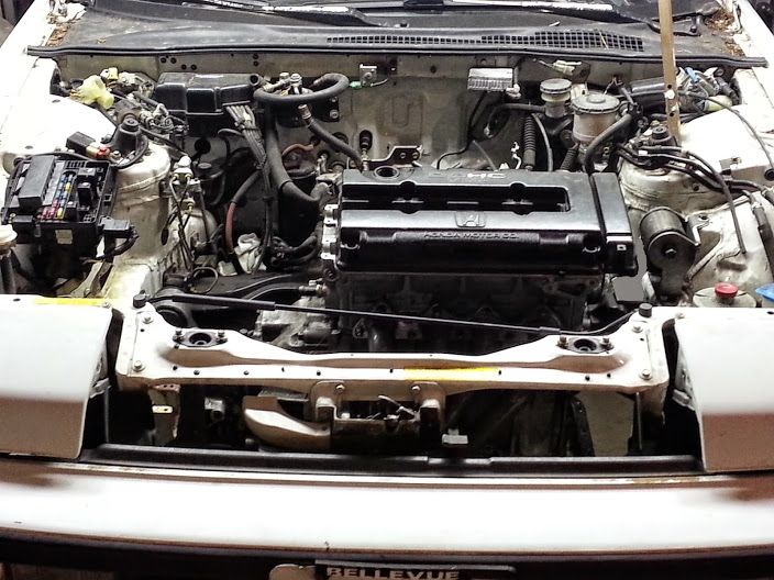

    New design for the H22 kit by www.1funryd.com (me)
    H22 kit produced by Cheddaauto.com
    And my B16/18/20b swap kit -
