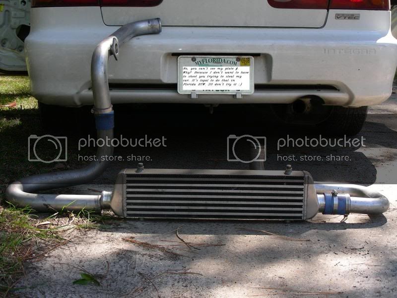

You guys are so upset about this whole thing. I don't have any bad feelings about it. Actually, I feel GREAT about it! I wasn't very comfortable running the setup I had. Cheap BOV, WG was a little too high PSI for what I wanted, charge piping was iffy (cold side)
This gives me time to make it right.

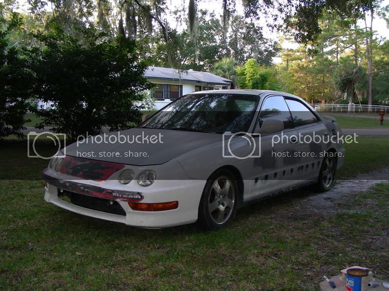

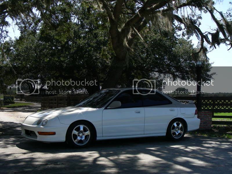

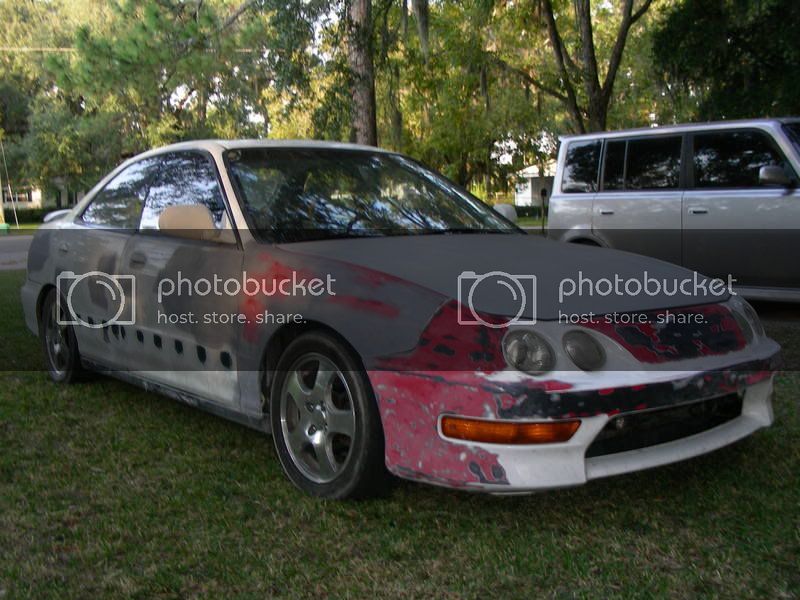

**Edit** I won't bump your thread with my stuff... But you know I gots ta stick my freshly painted baby in here!
And this covers the overspray in the front :)
Now, you guys talk Andrew into getting his car sprayed! Cost $250.00 :)
