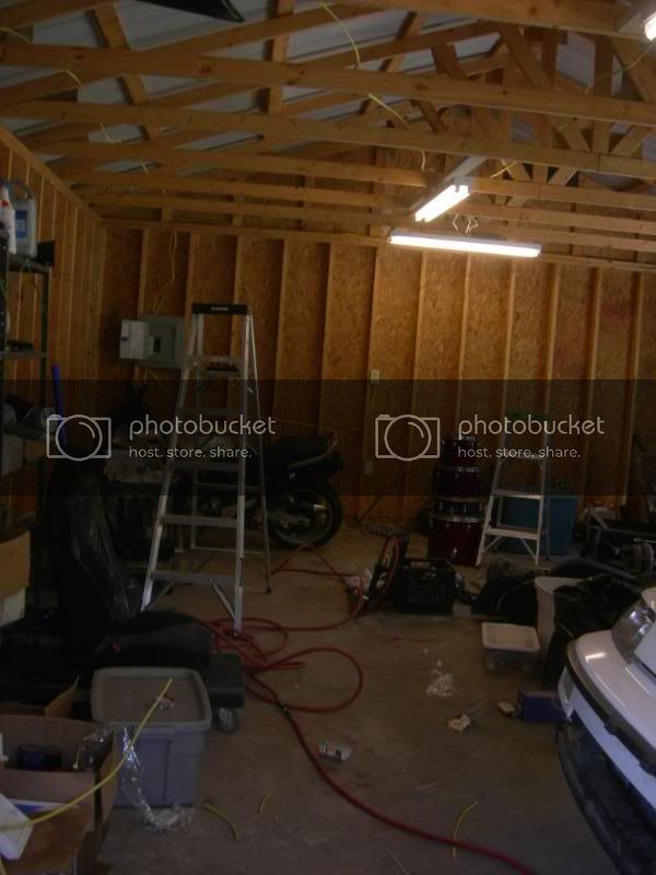

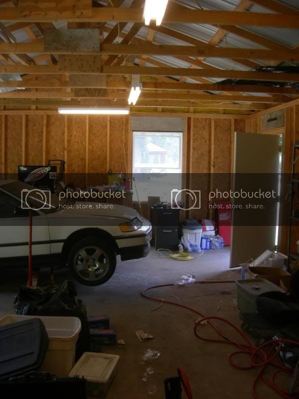

But most importantly I've been running electricity to my shop! So I now have lights to work with, and outlets and such. So my shop has been a wreck!
So I guess I'll have some more updates as I continue on making progress on the car.
