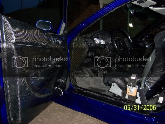

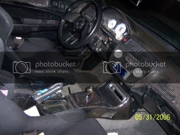

They more than suck!!!...there more than a fucking headache!!!...I swear I'm going bald from the stress the last 2xyears....dads been pressuring me to sell it but there is alot of history,money,time,in this...I could write a book on it!!not too mention it was a father/son project in the end..we fixed from 3 others shops that completely tore it apart..and loss parts like the doors,windshield when they moved location....3xlayers of Bondo from them warping the doors..big chunk cut out of the rear quarter for tailight conversion..I can go on and on...all the metal fab/weldsand paint my dad did...and i did the grinding,wet/dry sanding,glass work,and the whole interior in carbon fiber!!..yes everything!!!well everything but the carbon bucket seats,shift knob,and floor;) I just wish it was done on time back in 99-2000!!!I'm very pround about how the interior came out!!!...it took me 3xtimes of trial and error to get it right so it holds up in the hot sun etc..and alot of R&D!!!BUT,IT WAS WELL WORTH IT!!!by the time the car was all done I was literally done with the scene,all the big name sponsors who wanted to sponsor the car when it was done etc got no response from me...I only entered it in one show(NOPI)and got a huge response!!..I"M DONE!!!

oh holy shit bro that interior is fucking amazing...
now you got me seriously thinking of doing the same thing in my Si :wub:

Thanks bra!!...I busted ass to get the carbon done and dnoe right...I use to be huge in the scene..I had all the mags and went to all the local shows and back in 97 I was like I've never seen a full carbon interior except in Japan...I thought the car would be def.done by 99 but,I've been screwed way too many times by friends,bodyshops,parts etc..that it delayed like 2-3 yrs!!!so by the time everything was done I'm just burnt that I just want to enjoy the ride and drive this car!!!....anywho....I bought the O2 "Fouler"plug put that in and drove it for around 40 miles plugged it up in the diagnostic and the CAT passed!!!....the O2-Evap are still not complete....I figure I just need to drive the car a lil more....I just need one more to pass and it should pass emissions....I know in NY you can get away with two not passing but,I haven't taken this car to an emissions place in like 4 years!!!my boy does emissions I'll have to give him a ring....I don't know anyone anymore with a 96-99 civic so skip trying to buy another ECU...any other suggestions? BTW it just amazes me as many sites,friends,dealerships,Jackson Racing,tunners I've been to no one knows or can pin point what might be the problem!!!not even my dad!!!...and he is Macgyver!!!

ps/ot- where exactly in NY are you? I'd love to check out that interior up close, do you still have the molds for it?
Well I did put the O2 stimulator on but,I don't think that was it....I just needed to drive it on the HWY to get the CAT hot which was pretty easy...it was running a lil lean and running no boost..it ran literally worse than stock!!!the gears felt very looong...I drove the car in 4th on the HWY and 5th at like 85+...and if the HWY had a slight slant/hill I had to down shift just to get up it!!!it has absolutely NO torque..kind of scary to drive in the daytime so I usually wait til 1-2 a.m...;) ...I'm in Atlanta..but,yeah emissions is the same here as N.Y...I got away with 2xNot Ready....as far as the carbon...I have 2xfriends that work for Panoz who do it for a living..they told me to make molds but,it was going to be expensive and that I should put it in producton and sell it if all that work was going into it...well the way they do it is stronger and lighter...of course but, I didn't like the way the weaves in the carbon came out all flat...kind of like the"fake look"...cause they use "Pre-preg"(Kept in the freezer)carbon which they heat up in the oven...not to mention after talking to my friend he said in acouple months they were going to stop using the"Dry Carbon"and just use the"Pre-preg"which I was buying from my friend for 1/2 the price:D but,then my friends at Panoz said the way I wanted to do it(wrapping the panels) wasn't going to work!!!...so that sounded like a challenge to me...did alot of research after doing both door/arm rests panels,A/B pillars 3xtimes...finally I was confident enough to do the front/rear dash where all the sun hits....that you only have one chance to get it right!!!!...well everything holds up fine now except the rear side panels are lifting a lil cause the panel is so thin it absorbs the heat like a sponge...I would need to lay a few sheets of fiberglass underneath to thicken it up so it won't absorb so much heat but,that would be later when I have time...which I don't right now cause I have a new project...a 64 VW bus keeping me busy!!!!...overall my friends at Panoz were very surprised how it came out and holds up...the hardest thing about working with dry carbon is stretching the carbon where you want it and wet sanding...wet sanding I think was the hardest thing believe it or not...I'll take more pic.s of the carbon for you though so you can see what i'm talking about..give me acouple days and I'll put up alot more pic.s for you...Thanks again for the help stmotorsports!!!:clapping:
