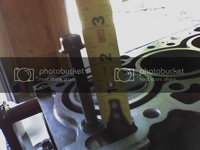

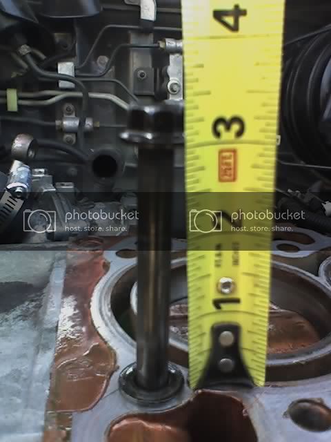

so today I pulled my b16 head off and use the same head bolt in each block in the same hole and measured it and I did take pictures and there is a huge difference.
b16 head bolt in B16a block
b16 head bolt in b18c1 block
so as you can see there is a 1/2 difference and all it did was hand tightened the bolt, so now I see the difference, the gsr block has deeper threads than the b16 block so i am going to get the ARP head studs for a gsr, like most poeple have been saying.
would you mind comparing them side by side when your arp studs come in? im curious about something.
why does it look like your one block was paint with copper spray gasket inside the galley ways.
cause when I put my b16 head on the b16 block I used copper spray, the b18c1 block doesnt have any spray on it cuase i just got it last sunday, and i am taking it to the machine shop on monday for new bearing, rings, crank machined, and block is going to get honed.
you sprayed on the actual block? i think all you needed to do was just spray your head gasket with it, thats what i did with mine and it turned out fine. you were running a hg right?
yes I was running a OEM Head Gasket, and yes I sprayed the block then set the headgasket, then sprayed the headgasket, and then installed the head
