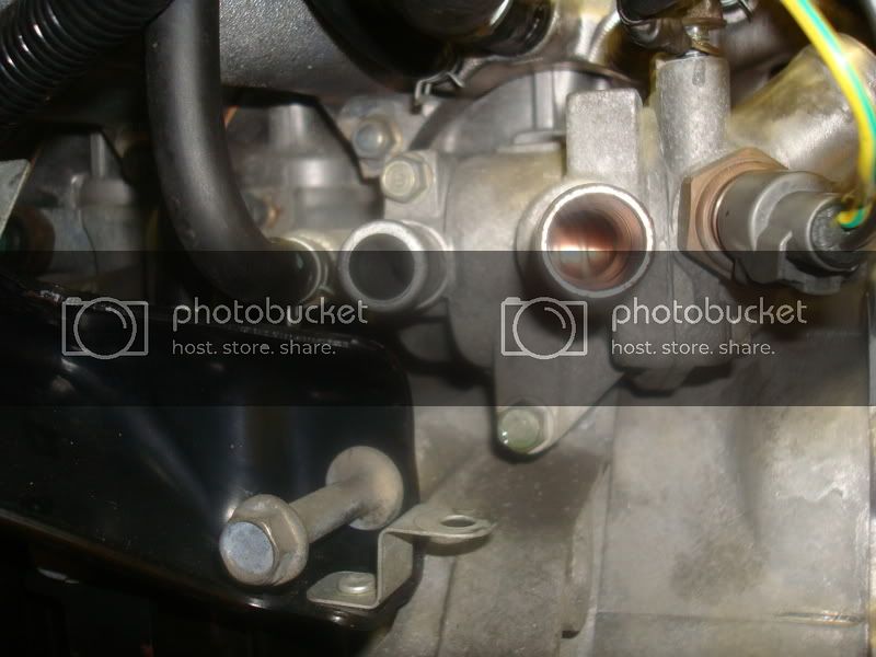

I just put a b16a sir II into my 1991 crx si and I cant recall where the bypass hose goes. I know where it connects at the top but at the bottom there are two possible spots to slip it on. Refering to this picture should it go on the right or left side. Thanks for the help in advance.
i dont have a temp sensor in the same location as yours on my b16a... but if those are the coolant lines next to where the lower rad hose goes, the one closer to the sensor goes to the heater core, the other goes to the coolant port onthe intake mani on the passenger side.
