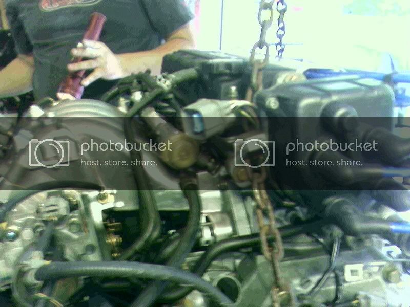

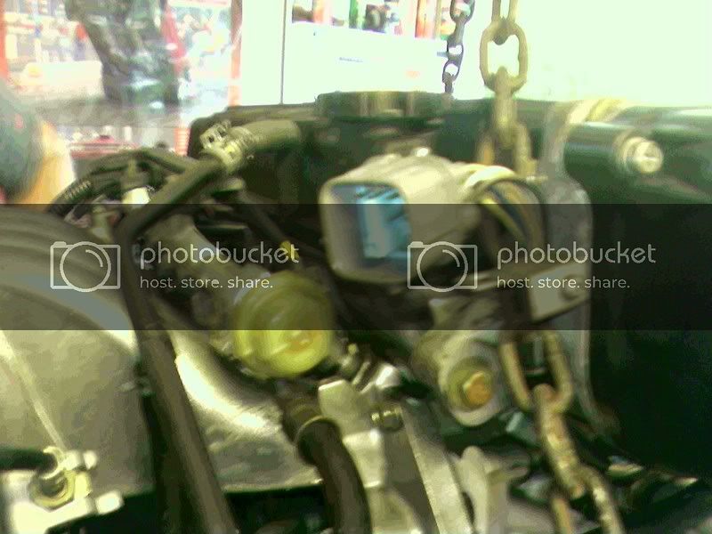

    im swapping a b18c motor into my 99 ex coupe. there are some spots where sensors do not plug in, what is this sensor for? the one coming off by the distributor
    also there is a sensor on the power steering line, does that plug in to anything now?

  3. AHHVTEC
    AHHVTEC Well-Known Member VIP
    13,136
    254
    Oct 13, 2006
    Alabama
    umm from the pics it looks like its for the dizzy
