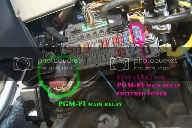

Taken from PGMFI.org
oh lol. well shit i was looking at the small black one that was immediately behind the hood release. how would u tell if it was bad?
