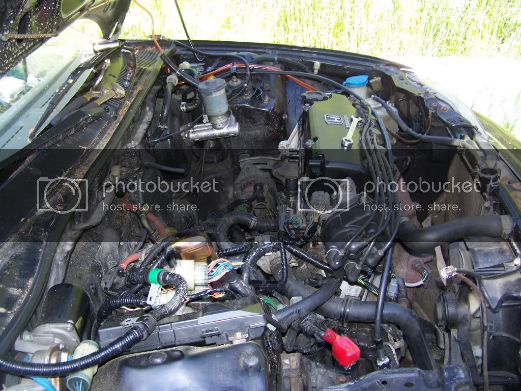

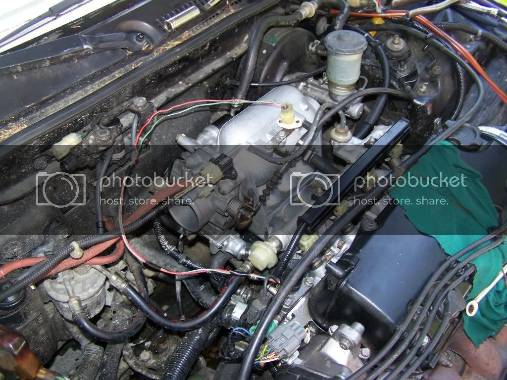

So far I have the old one off and I'm almost done the wiring. Its been about 1.5 hrs, not too bad for a 15 year old.

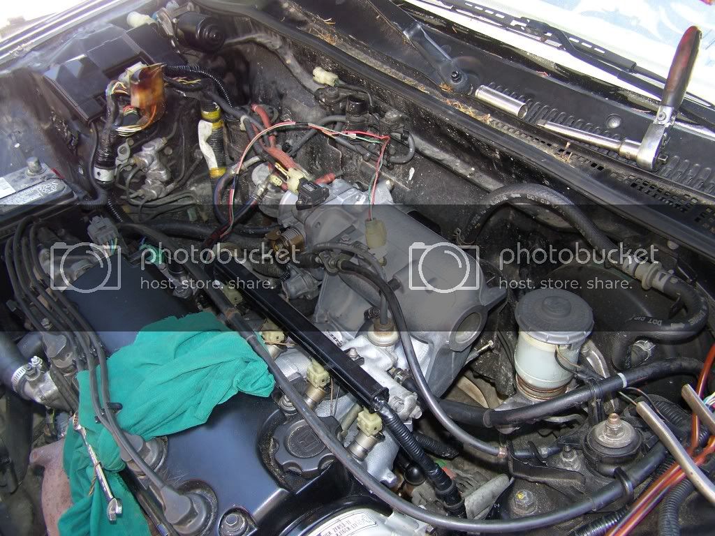

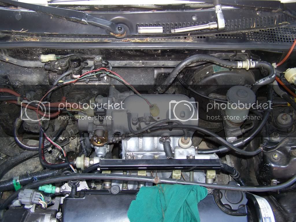

All in. I tried to strap down the D16A6 fuel rail but failed miserabely.
