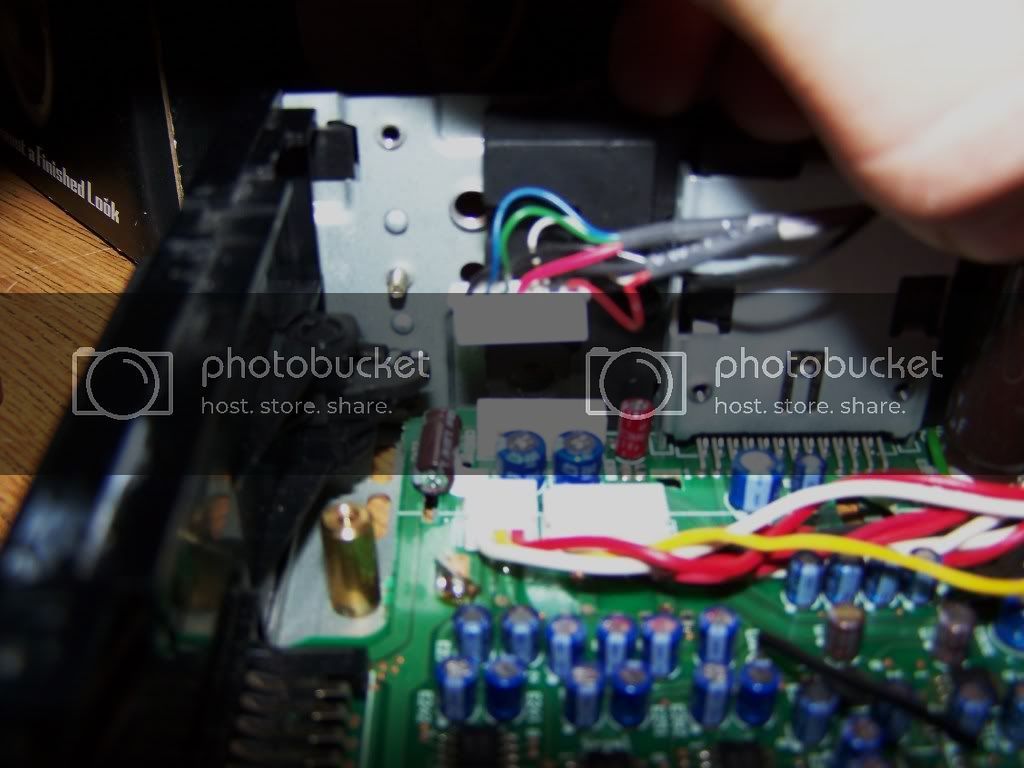

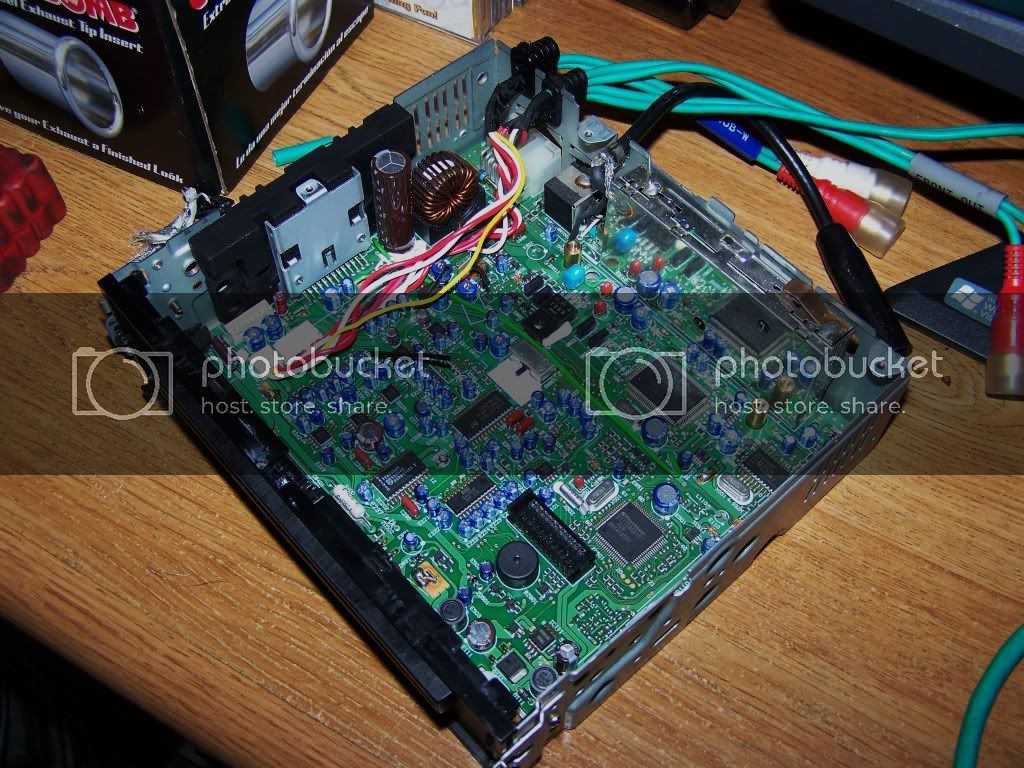

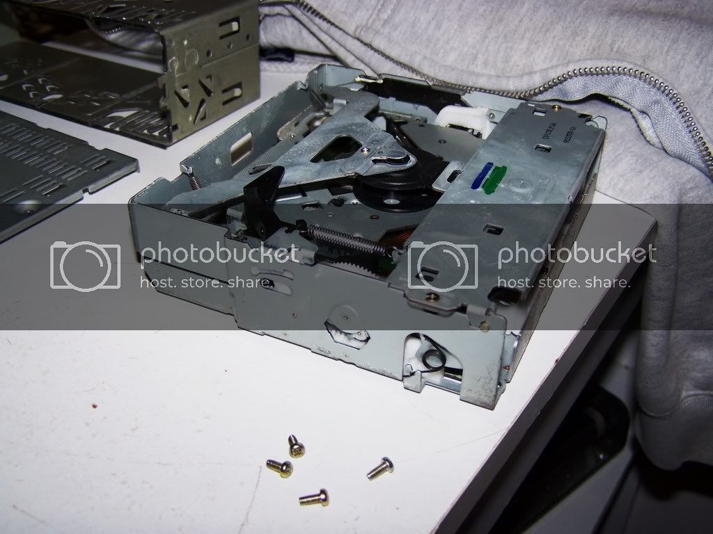

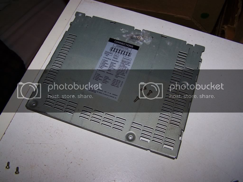

    First I took off the three top cover screws.
    Then the four screws for the actual CD player of the deck.

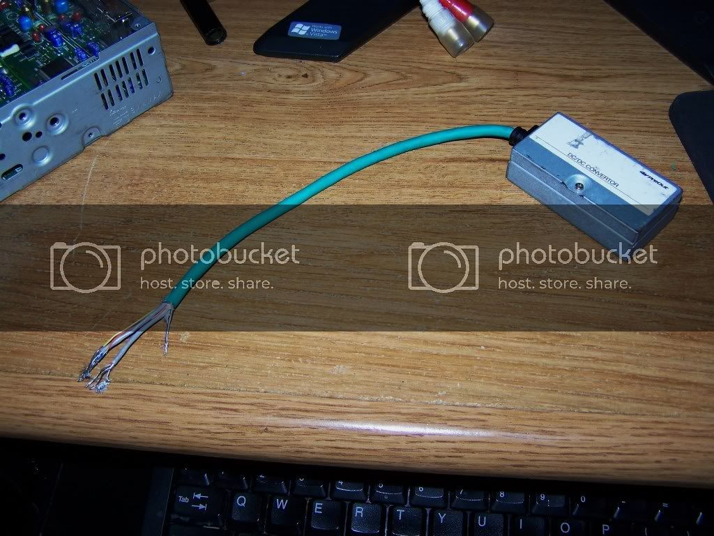

    And I saw this. I need those wires on the left side.

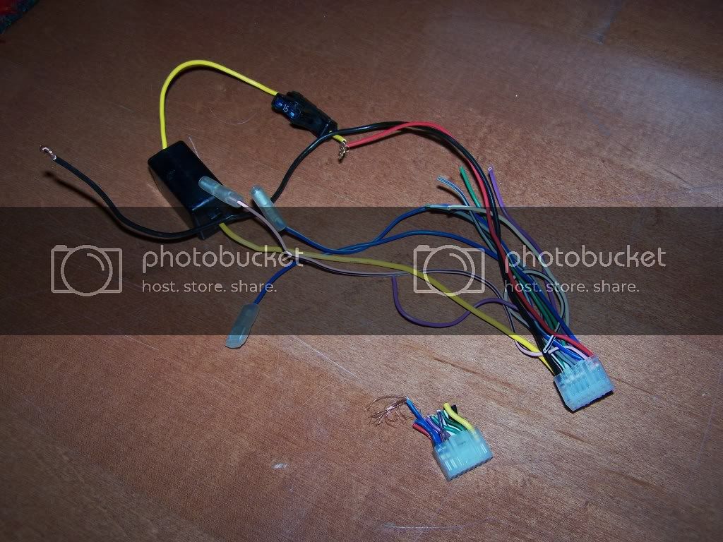

    What got cut :
    And this. I found a spare harness from a super old Pioneer deck. The harnesses were identical. :)

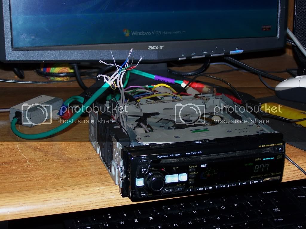

    I unpluged the cut harness from the inside of the deck.
    Matched up the wires.

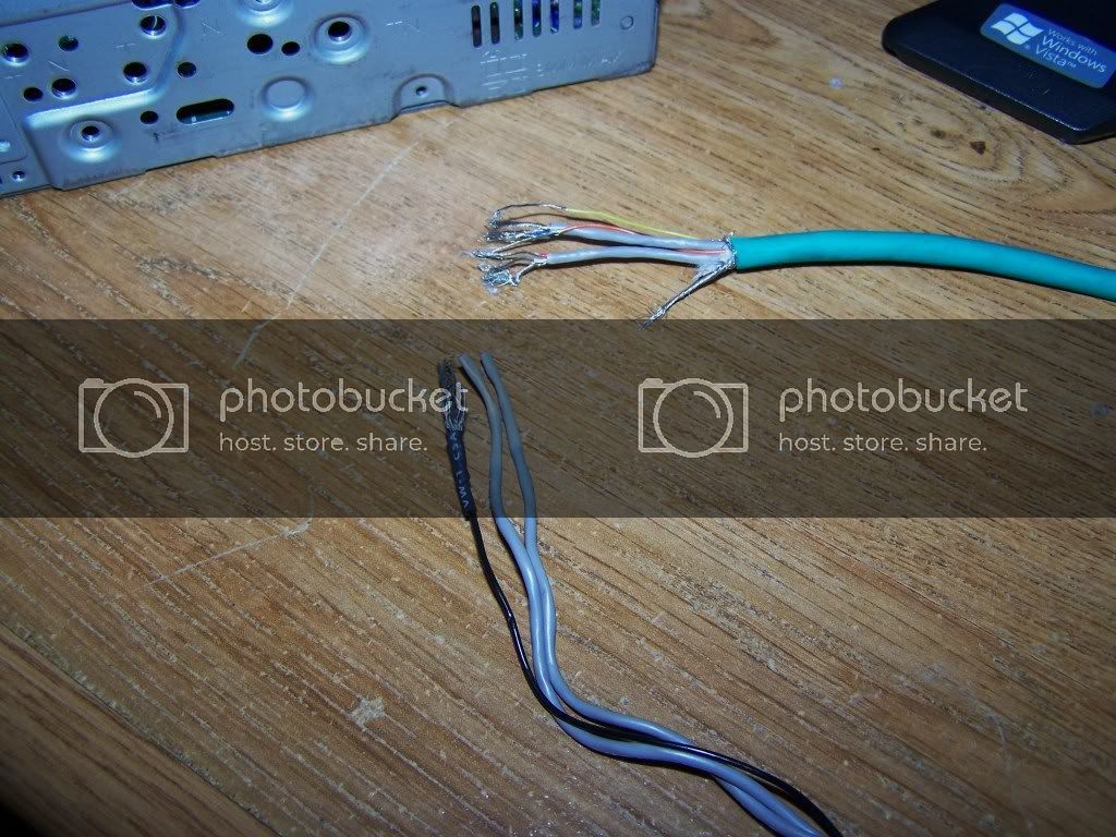

    Tested the deck with all wires connected.
    Then soldered, heat shrunk and taped up and you don't even notice I was in there. :ph34r:
    And thats how I got my free deck today. :)

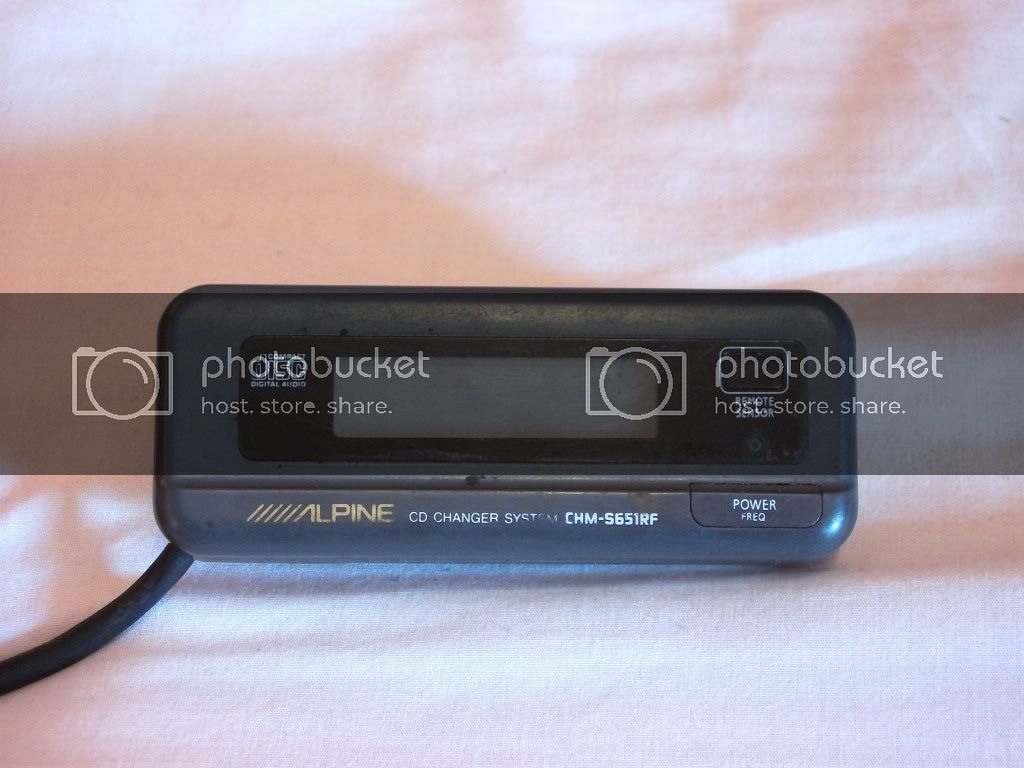

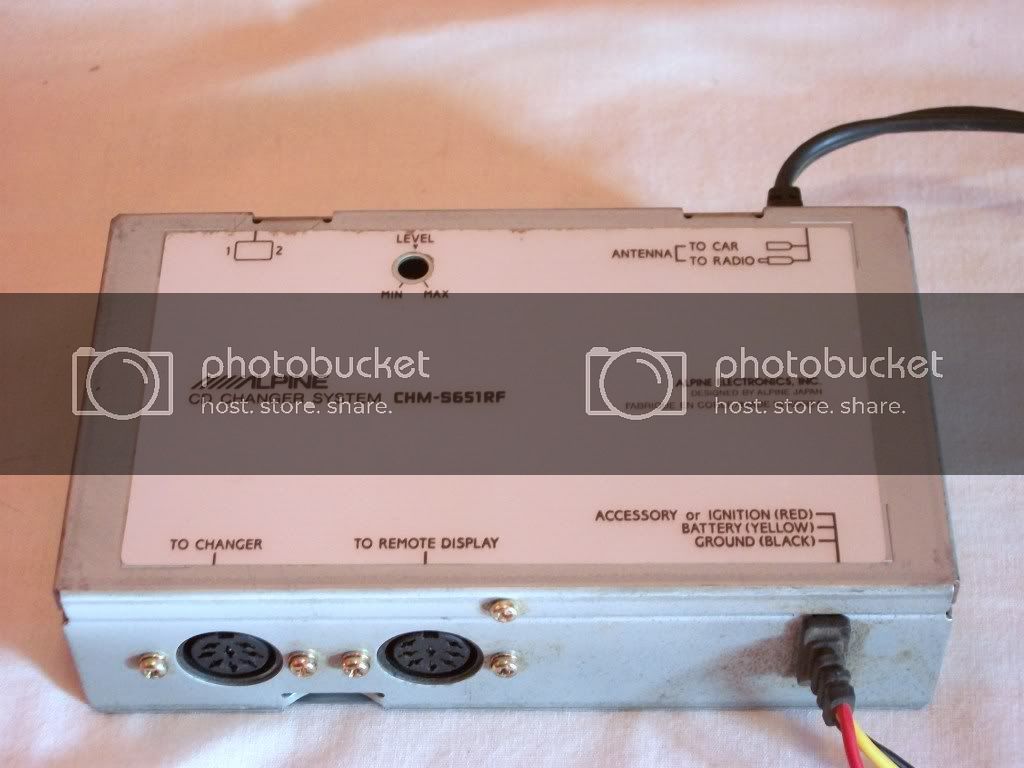

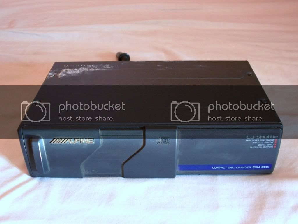

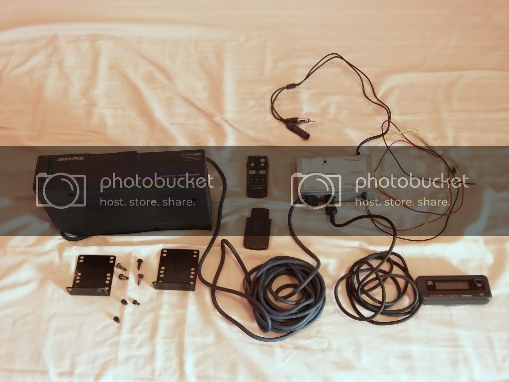

    *UPDATE ! MORE OLD SCHOOL CONTENT !*
    The buddy who gave me the deck has a girlfriend and she loved his teg, so she got one too and it came with the stock deck and a Alpine CD changer from 1996 ! I installed her new deck and she let me take whatever I wanted. :)
