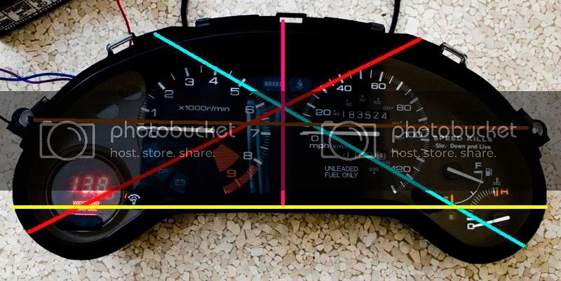

i just need the measurements then ill buy everything!! please someone get me the measurements of the delsol cluster!!

and these are the measurements i need of the sol cluster:
yellow
brown
pink
red
blue
