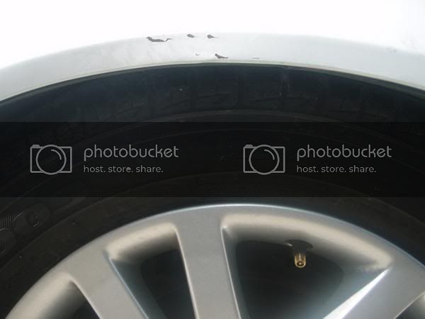

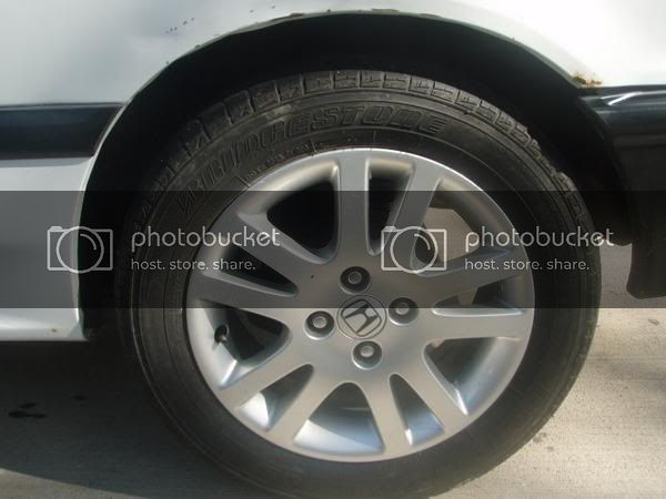

    Ouch! Ill keep that in mind. I already got my car lowered and its GREAT! I love it. But I need a camber kit LOL Ill post pics here!
    EDIT:: Pics! Tell me what you guys/gals think.
    Before:
    After:

    Very nice! Those look sick. I wanna see how it looks like on the car.

    the adjustable upper camber plates arent applicable for this car tho.. camber is adjusted by upper ball joint/control arm positioning... not the struts... so if he's interested in adjusting the camber.. he'd still have to invest in camber kits..... Aaron did you have the car aligned after you lowered it? be careful not to mistake camber wear for toe wear... at 1.75 degrees at least half of your tire should still be in contact with the ground.. so the whole inner half of the tire should be worn out.. if its just the inner edge id be willing to beat that your toe settings are out.

    To the OP, your car looks great now.
