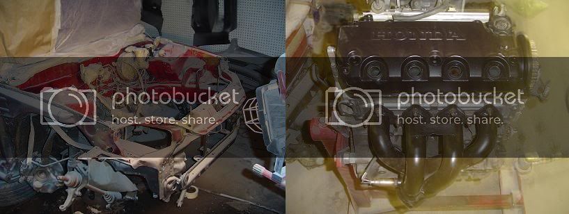

I am swapping out my D15b7 for a d16y8. Im having trouble with what to do as far as the wireharness..I have my old d15 harness but am not sure if the ecu will run the d16 ( i would have to run v-tec wires as well.)I only have the partial harness for the d16 and the ecu. What should i do? I know very little about harness and electrical stuff.
if i should use a d16 harness then does anyone know a place where i can get one.
