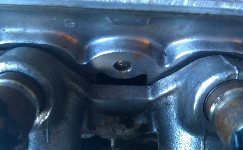

    So I'm swapping a d16Y7 into a 95 Civic with a d16y7 (JDM). Everything looks good but the intake manifold. I've searched several forums and everyone seems to think the manifold should match up.
    My thinking is to JB weld the top of the water passage and use the newer manifold gasket. Or would the gasket be enough?
    Thanks for any thoughts/help.

  3. Martin Malley
    Martin Malley New Member
    3
    Oct 12, 2013
    Some pointed out that "passage" only goes back a short way. Got eye level with it and saw there is no water passage.
    Crises solved!
